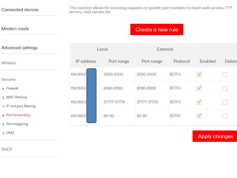

on your port forwarding image what are those rules for? Those ip addresses are not public so you can post them. You will have 1 public IP address on the WAN public side of your virgin router. Public ip addresses are usually not fixed and is why you need a DDNS account that keeps track of what your public IP address is.

On your Virgin router change these port forwarding rules
disable the rules with port numbers 2000-2000, 8080-8080, 37777-37778
keep enabled rule
external port numbers 80-80, 80-80 protocol tcp/udp
internal port numbers 80-80 80-80 protocol tcp/udp

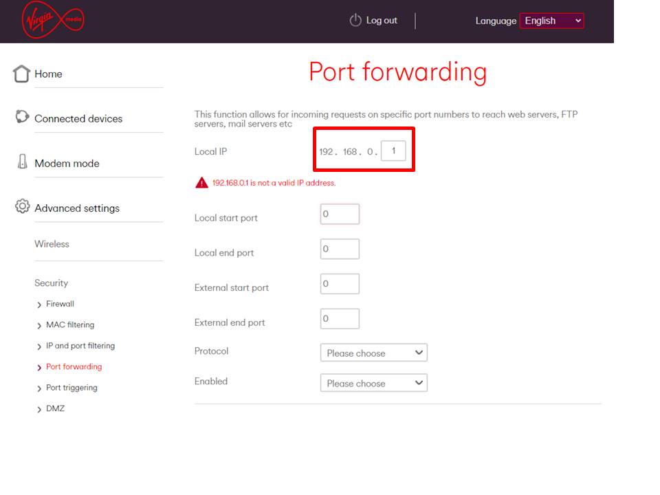

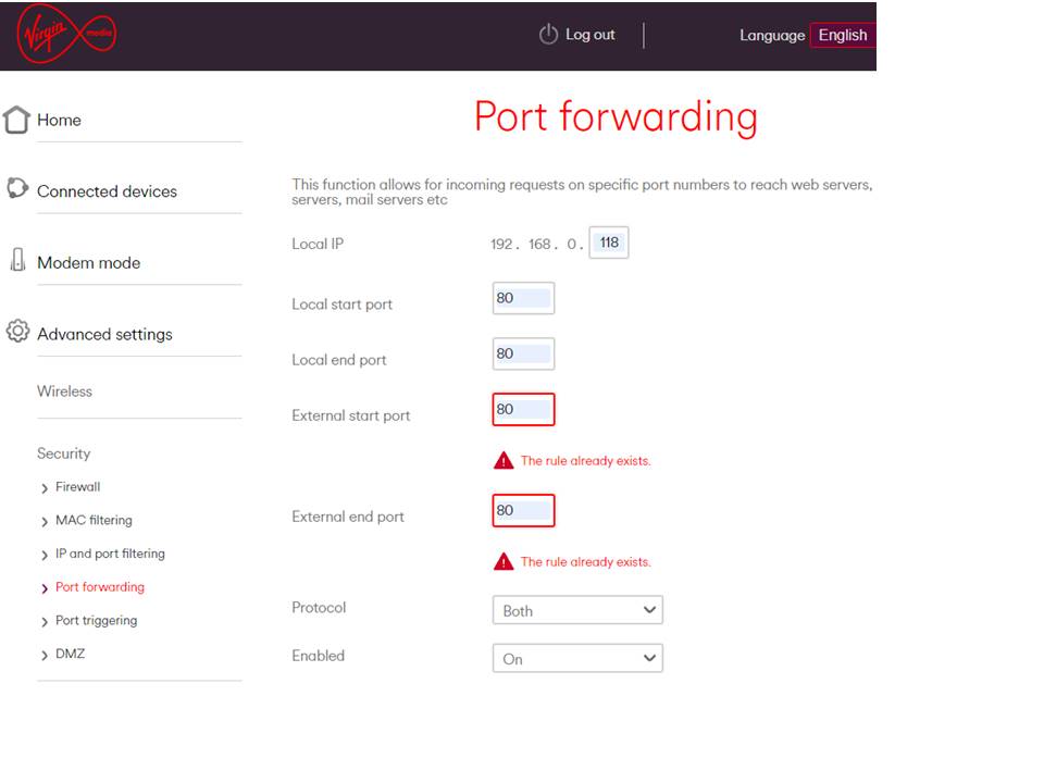

Failed already
I thought this number would be the router IP address but as you can see it doesn't allow it.
Should it be my DVR then which is going to be 118 ?
Done IPV4 address now. Opened port 80 but pinged and set DVR and router to 118.
Canyouseeme.org can't find me
Anything on attached that mat be relevant?

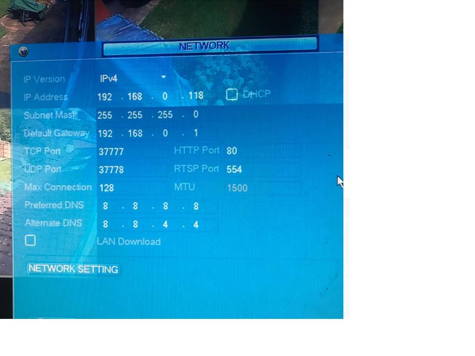

HI Steve,
your cctv dvr screenie image does not look right.
The IP address looks like your router IP address and the gateway IP could be your DVR IP address.
if your DVR IP address is 192.168.0.118 that should go in the IP address field, usually that IP address is assigned automatically by your router using dhcp.
If your router address is 192.168.0.1 then that is the gateway IP address.
Where did the TCP and UDP port numbers come from?

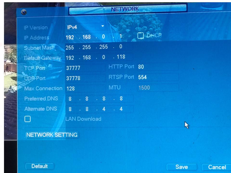

Thanks again David
I have swapped those around now as instructed (see screenie) and rebooted DVR just in case and it still matches.
I have had these numbers either from when it was installed in 2013ish or pre COVID when a Guy remotely took over PC to get it all working again.

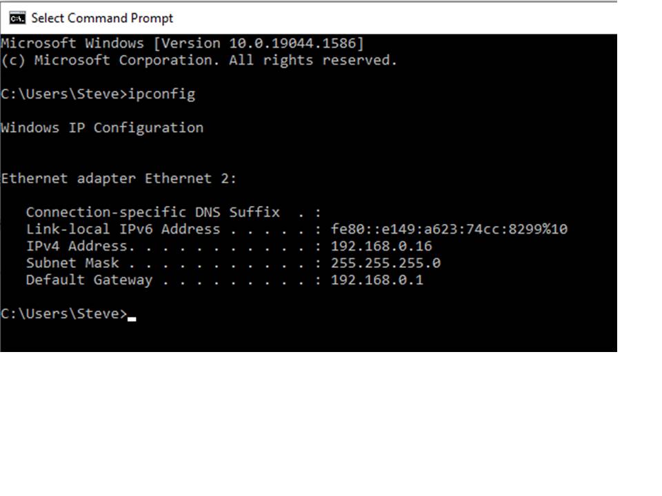

Is 192.168.0.16 relevant in any DVR or router settings?
I tried 192.168.0.16:80 (if correct + others 118 and 16 ) but the 80 in the address bar shows faint and the site cannot be reached. (see below also).
Canyouseeme.org still can't see port 80
From the command prompt (black screen) screenie your computer has an ip address of 192.168.0.16 and your router port forwarding is forwarding to your computer.
The DVR (blue screen) network screenie has not changed, is it the right picture?

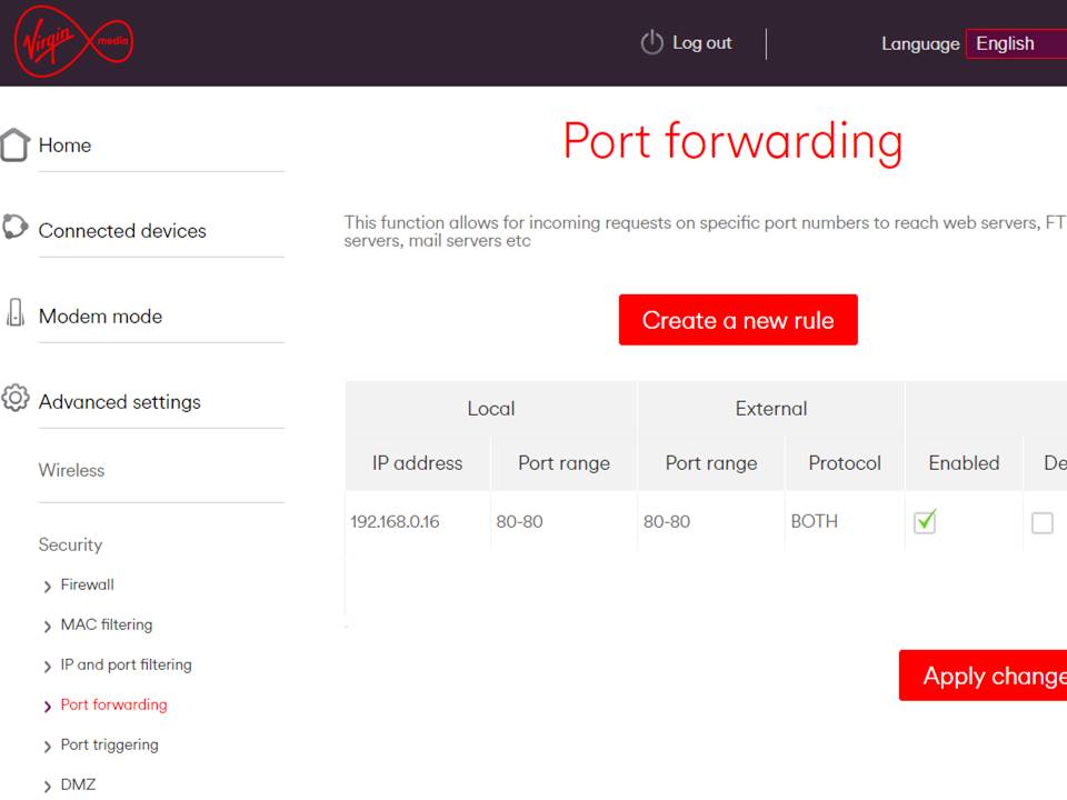

If your DVR's IP address is 192.168.0.118 then change the port forwarding rule IP to that.

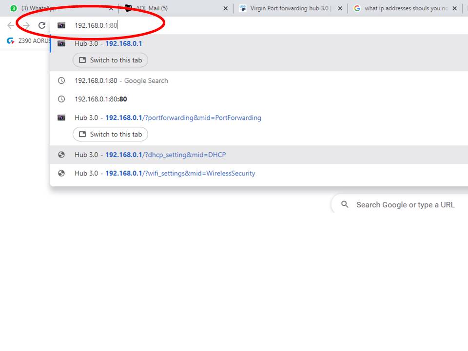

192.168.0.16 is your computer, the last image shows 192.168.0.1:80 which is your router, I think.
when using port numbers in the browser address bar use the full url... http://192.168.0.1:80
Sorry David. It was the wrong picture now updated
See the port forwarding pic.
Hopefully I have get rid of 192.168.0.16 and then the 192.168.0.118 one will work if not it looks like it will not allow both

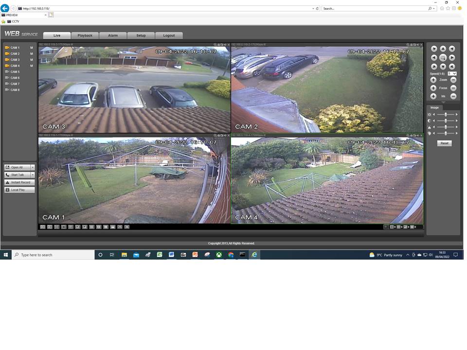

Well you're getting there !!!!

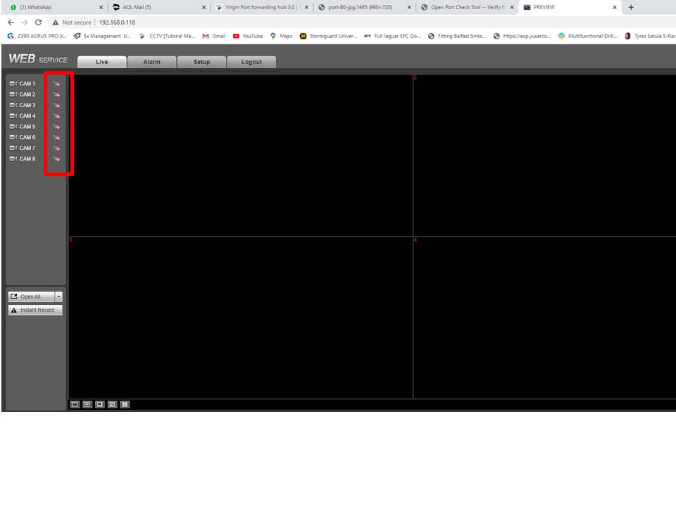

How do I get rid of red lines through cameras?
SORTED NEARLY
Now to get it on my phone FGS........................................
Look at the cctv web service network settings, make sure its connecting to your DVR. post a pic if you want
Is the remote access working?
Thanks David
All sorted really appreciate the help you gave me thanks so much.
Got it on my iPhone and my wife's too.
