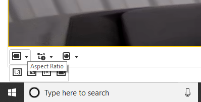

You can select the aspect ratio that you view, for instance when viewing a camera in your browser there's an icon at the bottom left:
