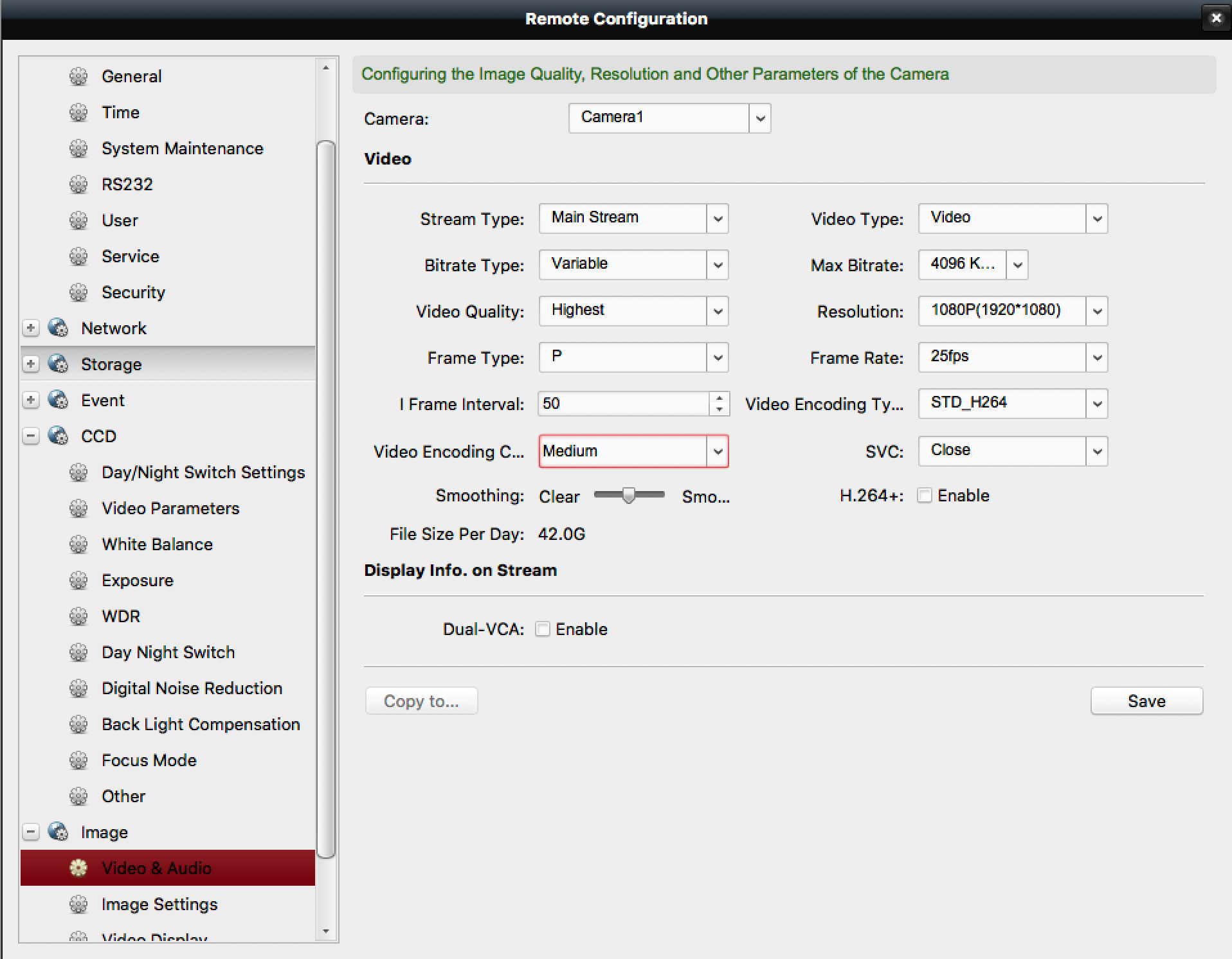

I can't find much (any) information about what this IPC-D640-Z dome cam setting does so any clues welcome.
It's outlined in red on the attached screenshot and the options offered are "medium" or "better".
I assumed that the video encoding complexity was determined by the other settings such as image size, fps, bitrate, etc so can't figure out what this one adds.
I asked Hikvision tech support about this setting and got this reply:
"Under the same bitrate, higher video encoding complexity gives higher image quality. We usually select “medium” for this option."
Hope that clears things up!
