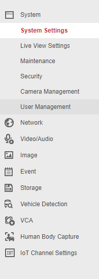

New to this forum as HikVision UK support refuse to help me as I'm not a trade customer. I'm hoping someone here can help.
We have an NVR model: ds-7732ni-14/16p and a people counting camera model iDS-2CD6810F/C. I have checked and both are running latest firmware.
The camera plugs straight into the NVR and auto-sets up. I can log into the NVR through the website and watch the camera fine. In order to calibrate the line and settings for counting though I am aware I need to use the web interface of the camera or through the NVR interface.
I found this video:
but my NVR doesn't have "people counting" in the left hand menu of the configuration screen.
I have: vehicle detection, VCA, Human Body Capture options but no "people counting".
Anyone have ideas?

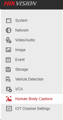

I've upgraded the NVR firmware:
Still only getting these options though:
Any ideas?
The user manual for your camera seems to suggest the People Counting settings should be accessed by logging directly into the camera.
If the camera is directly connected to the PoE ports on the NVR you will need to enable Virtual Host in the NVR setting to allow you to log in to individual cameras.
Not sure why it shows in the NVR for that YouTube video if the option is no longer available.
