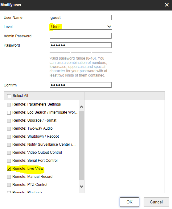

I have a DS-2CD2142FWD-I and have created two users (apart from admin), UserA and UserB.
UserA is type of "User" and has only "Remote: Live View" permission
UserB is type of "Operator" and has all permissions.

Just to mention that both UserA and UserB can log in to HikVision admin page.

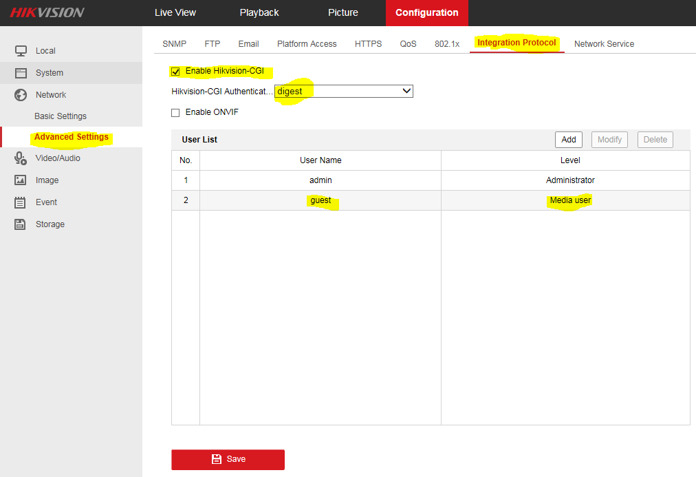

In Security>Authentication and RTSP-WEB Authentication I tried with both "digest" and "digest/basic".

I done everything you said but this drives me crazy. The popup keeps prompting for credentials untill it fails with
401 error Unauthorized.
If on this same popup I enter the admin credentials I get the picture.
Also, I am able to login to the back end with the guest account (which means that the guest credentials are correct).
