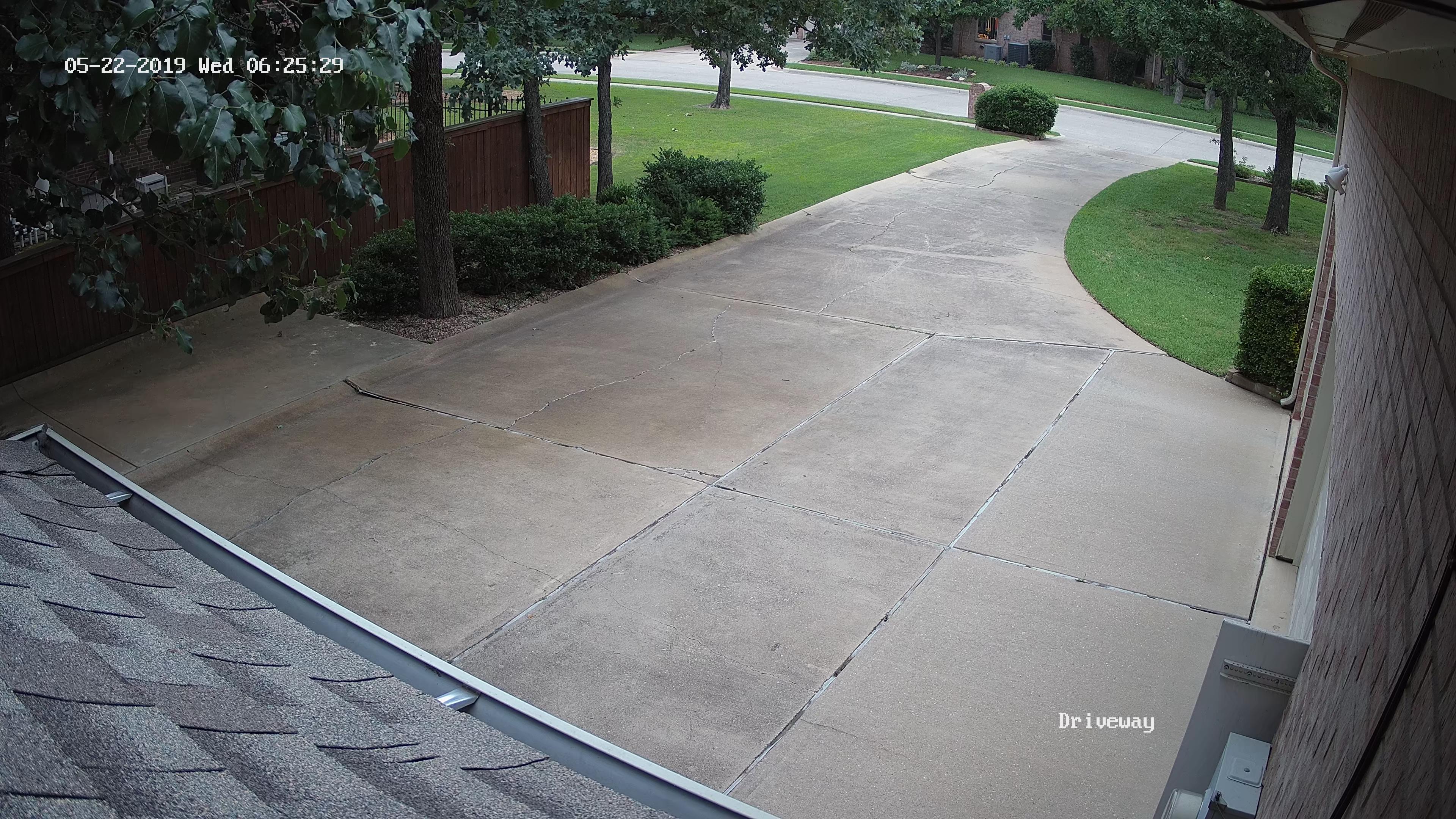

I bought the 2CD2385G1 and it's fantastic, would highly recommend getting it. The 2CD2385G1 is still fairly new and not sold everywhere so I think that's why there's a lack of reviews, but it is the upgraded version of the 2CD2385FWD. I attached some screenshots from the 2CD2385G1.
Thanks Nuro for the screenshots, they do look good. Is that a 2.8mm or 4mm? I'm guessing the single hole design is better than the 2 small holes design (from the previous version) for some reason.

It's the 4mm. Only thing I wish was it did audio recording as well.

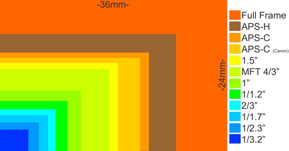

I was also looking to buy the DS-2CD2385G1-I. I noticed that the image sensor is smaller 1/2" compared to the DS-2CD2385FWD-I that has a 1/2.5 image sensor. Could you tell me the name of the new sensor being used in the DS-2CD2385G1-I so I can look it up.

It's a simple mistake to make but in sensor sizes a 1/2"(half inch) sensor is actually bigger than a 1/2.5" sensor which moves closer to a 1/3" (third inch) sensor. You can see this laid out in the table below:
2536
