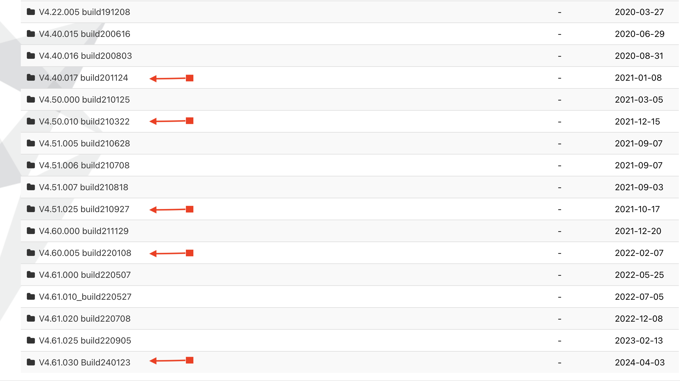

I've heard about needing to upgrade firmware gradually
You need a full list of previous firmwares for your model. The usual advice is to step through at least one version when the middle number (22 in your case) changes. I've not known an NVR/DVR to be bricked by ignoring that advice but who knows...
You want this page on the portal:
UK Portal
...and you want to upgrade through the versions highlighted:
