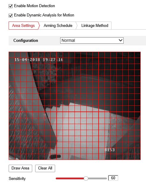

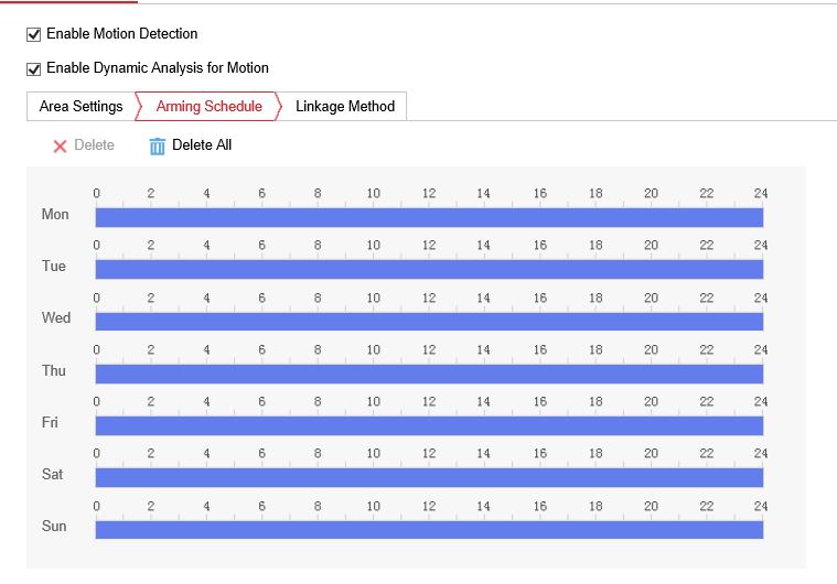

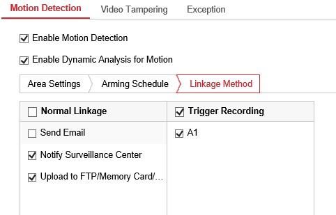

My cameras (DS-2CD2332-I) were working perfectly until I just updated them to 5.4.5.
All the settings I believe are correct to 'Notify surveillance center' however IVMS isn't recording the events. The events are working as they are sending snapshots via FTP.
Any ideas most appreciated.
Cheers

Hi Phil, ended up fixing it by power cycling the camera, previously I had only rebooted through the batch tool.
