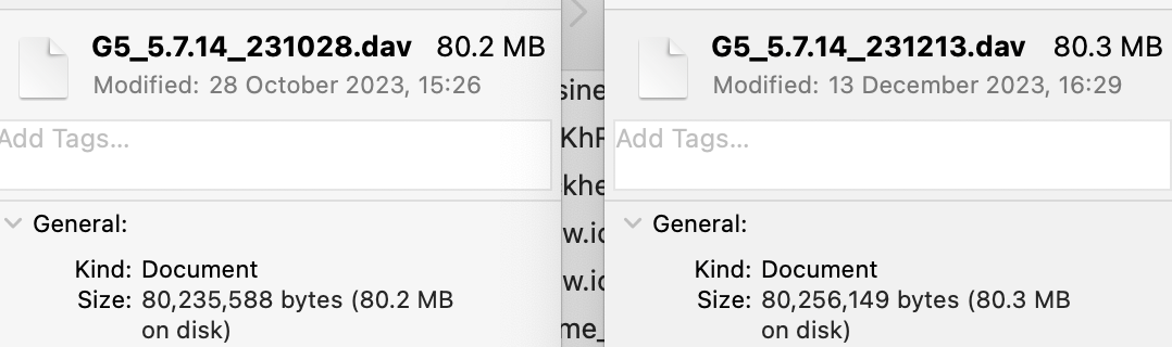

Definitely different file looking at the sizes. I've just loaded it on 6 cameras, I can't imagine there will be noticeable changes.

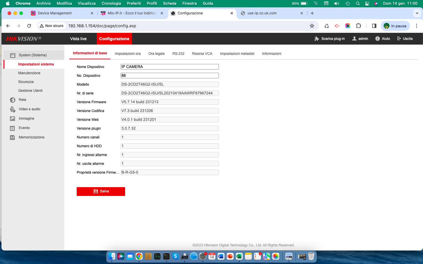

I did the update on my DS-2CD2T46G2-ISU-SL C camera and it happens that:
  • live View from browser is a gray page (I use PC Mac Air and Chrome browser)
  • on hik-Connect App live view OK
  • on ivms4200, live view OK
What happened?
Before the update I had the firmware V5.5.113_210317 and live view worked perfectly from the browser. I tried but I can't reload the previous firmware version. Can we go back to the previous firmware version and how?

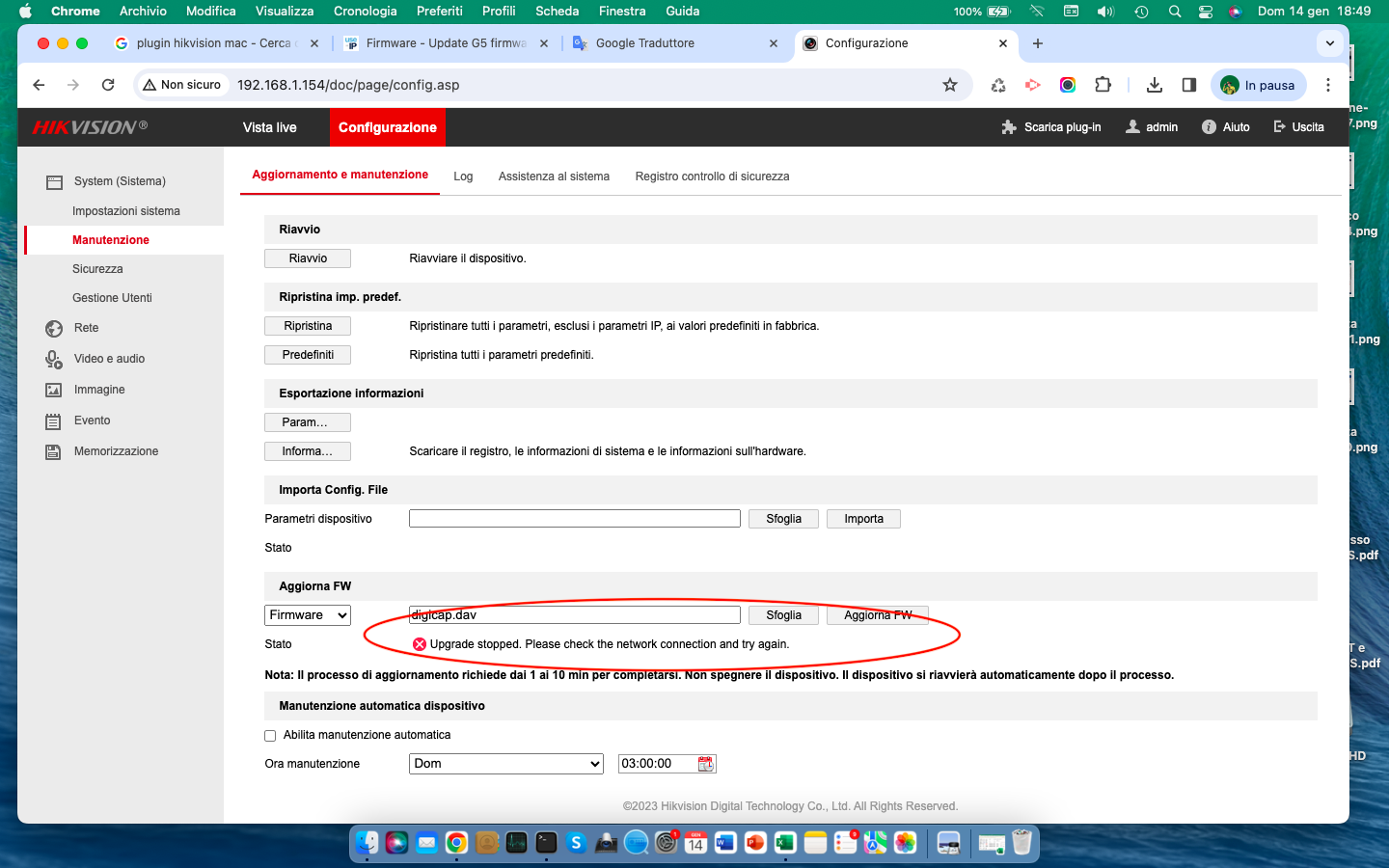

I tried to restore the previous firmware V5.5.113_210317 from notebook: it asks for the configuration password.
Can anyone tell me what it is?

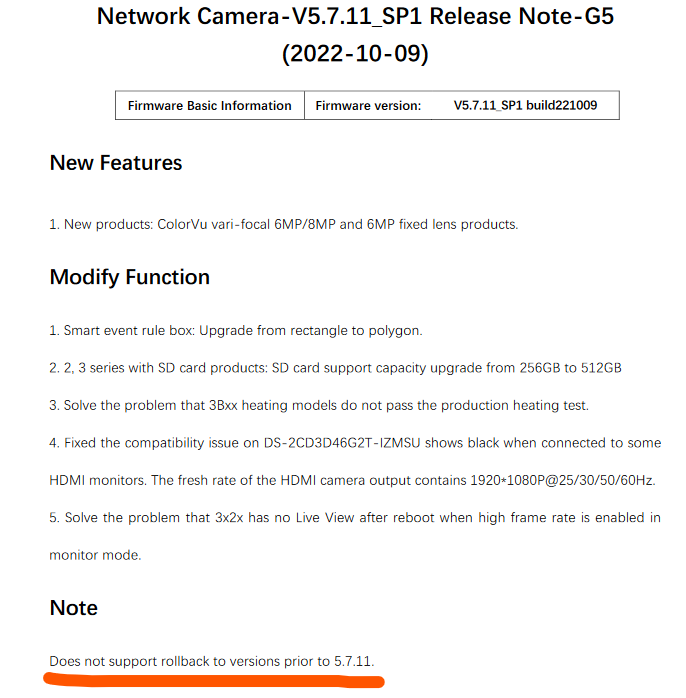

v5.7.11_SP1 and above, do not support roll back to versions prior to v5.7.11.
Possibly, you can install v5.7.11 but I believe there is no reason to.

In fact, I had read it in other threads. Now I would like to make sure that I cannot restore the previous firmware.
Do you know what the "configuration password" required during the firmware update could be?
Show a screenshot of where you're being asked for a 'configuration password'. The only password needed to access the cameras web interface is the admin password and that is something you or your installer created?
