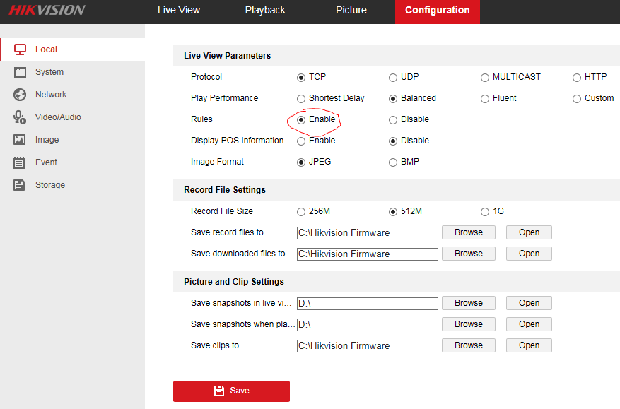

Running the latest version of Hikvision's WebComponents on your laptop? It should be 3.0.6.43 or close to.

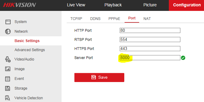

The colored markers in the browser are enabled/disabled on the camera via the Rules checkbox in Local>Configuration. If you have this enabled already, try Disable and Re-enable it. If that doesn't fix the issue on the laptop I suspect it's a port blocking rule with the VPN. Try changing the Server Port to one of the HTTP alternatives (8080 or 8008) on the NVR.
Alternatively see if you can open port 8000 on the VPN client or a perhaps a port forward. Keep us posted.
On the camera:
1919
On the NVR:
1921

rules was not enabled on the nvr, now i enabled it and can see the markers in IE on my laptop via vpn, which is great
thankyou - i didn't expect that to work, i was moving towards it being a VPN related issue and writing a vpn rule
thanks ever so much for your help
