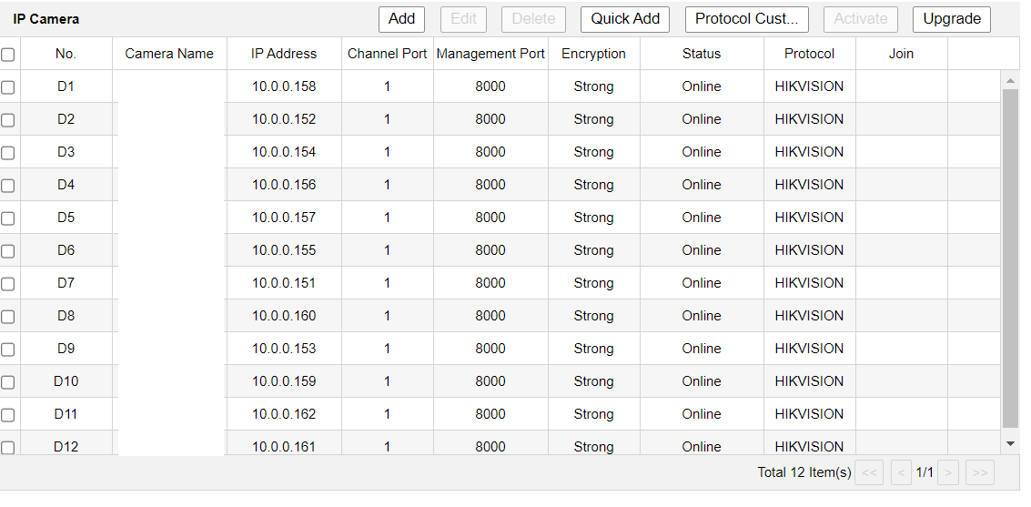

I have 12 IP cameras connected to Hikvision NVR (DS-7616NI-K2).
I recently upgraded the NVR to the latest firmware, and I wanted to upgrade the firmware of the IP cameras as well.

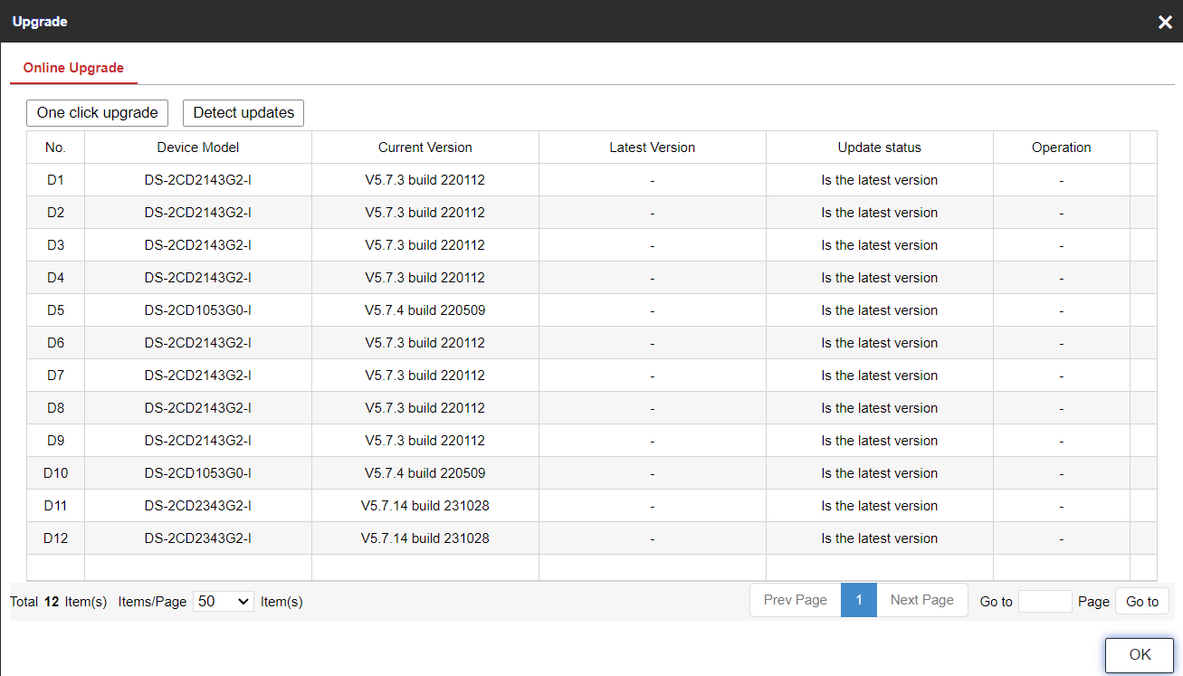

The NVR shows the cameras are all online (and I do see the video coming), but it seems like my NVR has no option to upgrade the firmware for the IP cameras from the NVR's portal from a file (only with "One Click upgrade", but unfortunately it doesn't detect the new version).
Trying to connect to the IP's of 10 of the 12 cameras directly over HTTP fails with time-out. I recently added two new cameras, and luckily I was able access their portal via HTTP and upgrade them manually (see image below).

I am looking for any way to upgrade the firmware for those cameras, either one by one or batch upgrade.

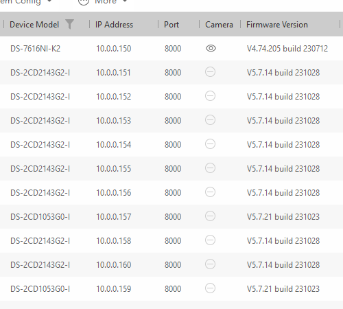

I do see all the cameras via SADP.

Unfortunately, the way you have cameras connected directly to the ports on the NVR means they are using the NVRs subnet IP range and those devices are not visible to tools like SADP or Batch Configuration.
The only way you might be able to update directly connected cameras using Batch Config would be to connect a PC/Laptop directly to the LAN port on the NVR, set the PC/Laptop to the same 10.0.0.xxx network range, and then you might be able to see all the cameras in Batch Config (but we have never actually done it this way so can't say for sure it will work).
