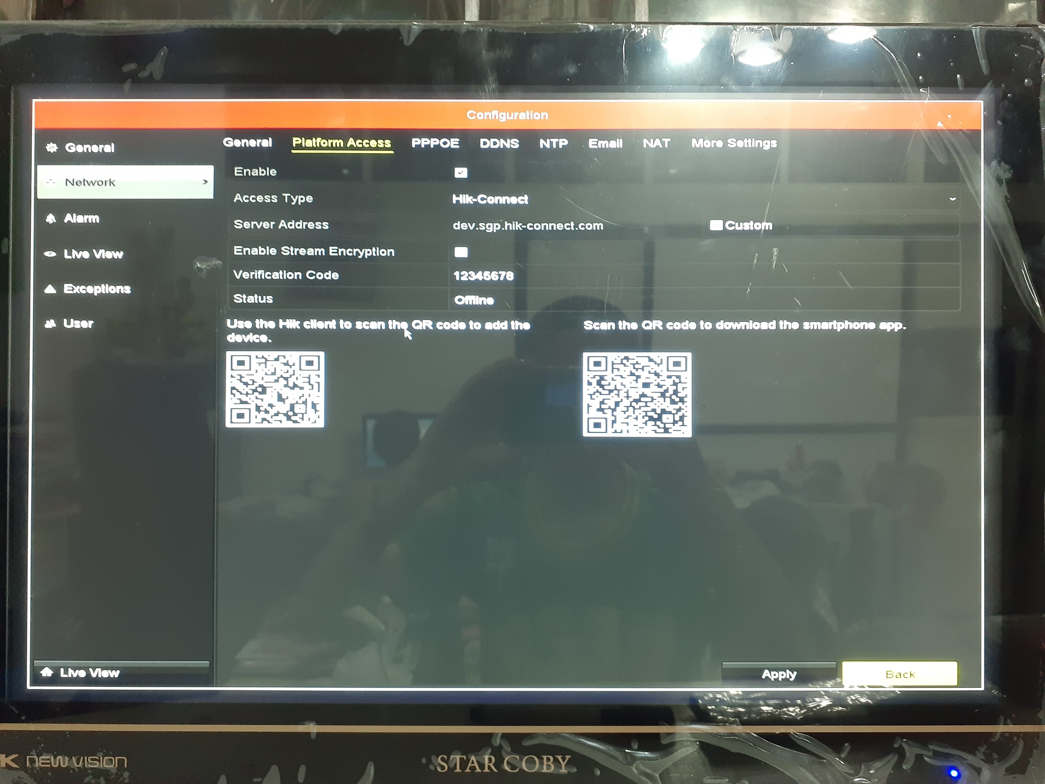

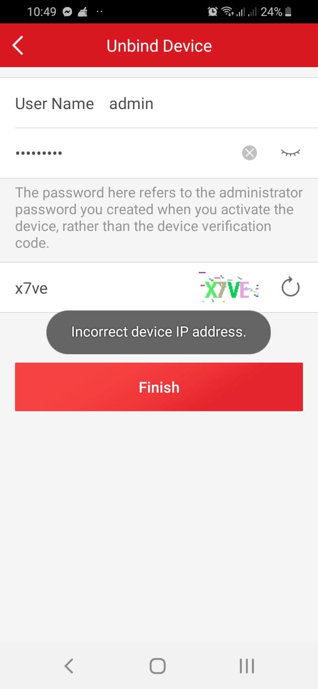

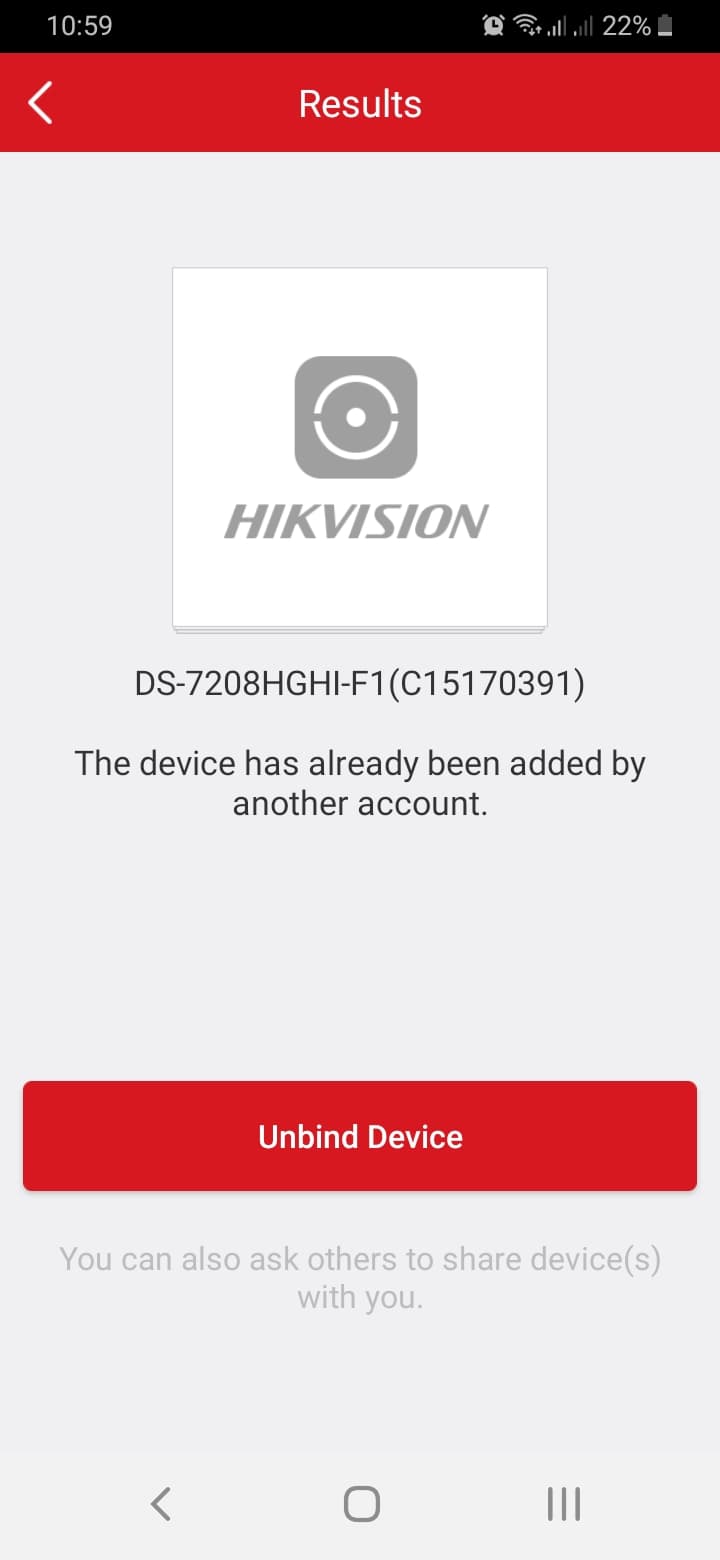

As shown in the pictures attached, I am unable to unbind the current device. As a result, I am unable to add the device in order for me to view the cameras through my android phone. I'm using the Hik-Connect app from google play store.
I tried scanning the QR code provided by the Network > Platform Access but it keeps saying that the device has already been added by another account.

You will need to contact Hikvision Tech Support and ask them to delete the DVR from all other Hik-Connect accounts.
