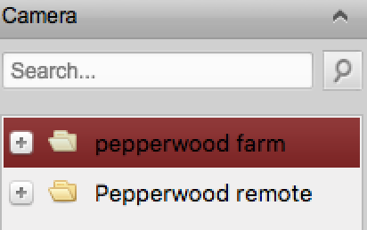

The camera system was set up by a security company - they have set it up so that remote cameras show up on iMVS4200 - I was told that these are the ones seen on the mobile app (Hik Connect).
I have run through the suggestions on the thread and have come up with these issues -
1. the DNS address is a router address.
2. on the platform access tab the server is set up as dev.eu.hik-connect.com will this make a difference?
Thanks for your help.
