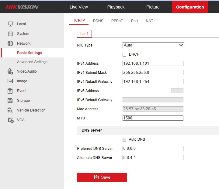

Sorry, really busy, and losing the thread. One of the common reasons I encounter for Hik-Connect problems is the Gateway and/or DNS settings not being set - please see image below.

Sorry, really busy, and losing the thread. One of the commonest reasons I encounter for Hik-Connect problems is the Gateway and/or DNS settings not being set - please see image below.

I've changed the settings as to be honest they wasn't right, I just used the routers ip instead. It hasn't made a difference though.

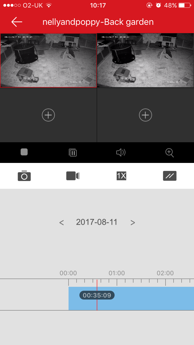

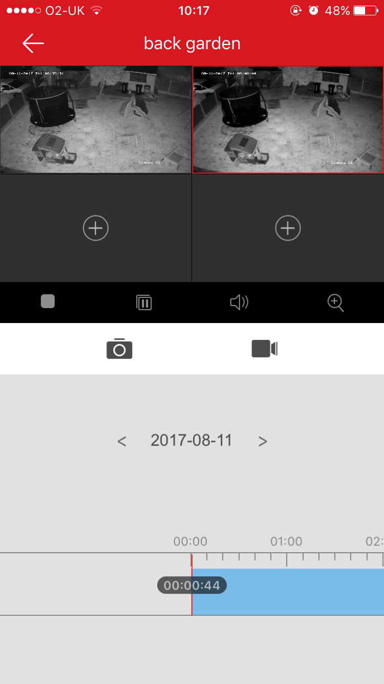

Here's a screen shot of my camera at the back, the left one is directly accessing the nvr via the domain/IP address (but that will change when router decides) and the right one is using the hik-connect method.
The left one allows me to to push through and fast forward if you like through the video, the right one doesn't and every time I try it buffers and goes back to start.
