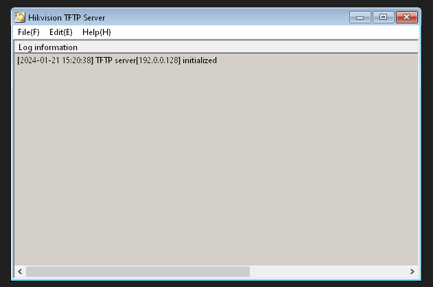

i try to flash a bricked hikvision iDS-7216HQHI-M1/S with Tftp but i am unable to do so because the tftp server does not react at all
it only says TFTP server[192.0.0.128] initialized
nothing else
i have tried to connect directly to the dvr and with a router to no avail
it seems for some reason the dvr is not communicating with the tftp server
anyone has any idea what i should do?

yes i have done this again now using a direct ethernet cable connection between my laptop and DVR
yes it seems my DVR has booted in recovery mode because it has 192.0.0.64 ip address and i can ping it
i have set The TFTP server and laptop static address is 192.0.0.128 SNM 255.255.255.0
no i don't have a link to the TFTP recovery procedure im following because for everyone else it seems to be a straight forward process but im running into an issue :(
here is picture of how the software looks when both devices are connected together and after rebooting the dvr it seems as if nothing happens as if the dvr is not attempting to connect with the tftp server
I've never used the hikvision tftp server software, here are some suggestions.
Your tftp server is initialised but is not seeing any connect requests from the DVR.
make sure your wifi is disabled.
the firmware file (digicap.dav) should be in the same folder as the tftp.exe file. Make sure you have the right firmware file, uploading the wrong file could permanently brick your DVR.
laptop antivirus could be blocking the tftp protocol, temporarily disable it.

yes my wifi is disabled i did exact same thing in the video and yes the digicap.dav is in the same folder
also i am running the program in compatibility mode windows xp
i also tried this on a different pc that had windows 7 but same issue the tftp server seems to not be getting the request from the dvr or something
i don't know what im missing
is there an alternative to the tftp software that hikvision uses?

i just want to know why my tftp server is not getting a connection from the dvr
and is that a common issue?

i have tried that python 2 tftp server script and it also gets stuck in the waiting for client phase
does having a smaller firmware stop it from attempting tho?
because even if the firmware is larger the client should at least attempt to connect to the tftp server
