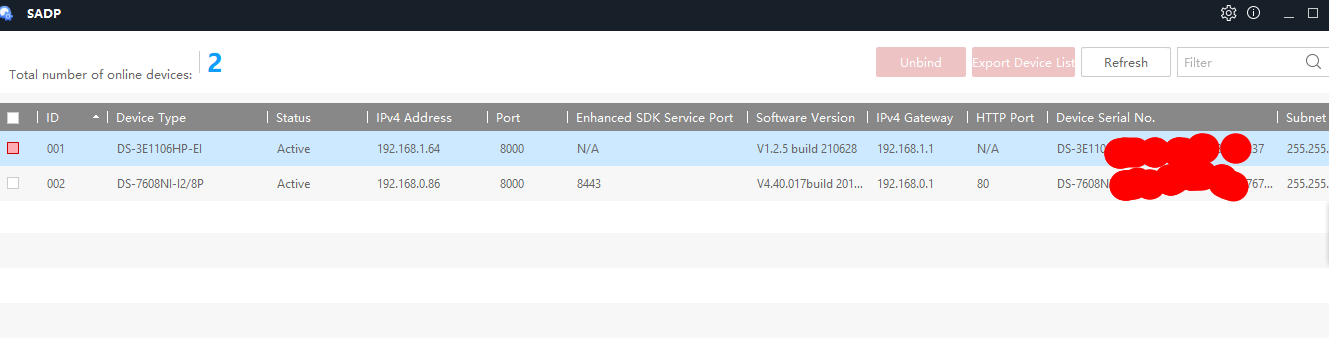

I have a HikVision DS-7608NI-I2 that we inherited from the previous owner of a house we just bought. I am able to connect to it using SADP and it shows this:
001 is the POE switch, 002 is the NVR.

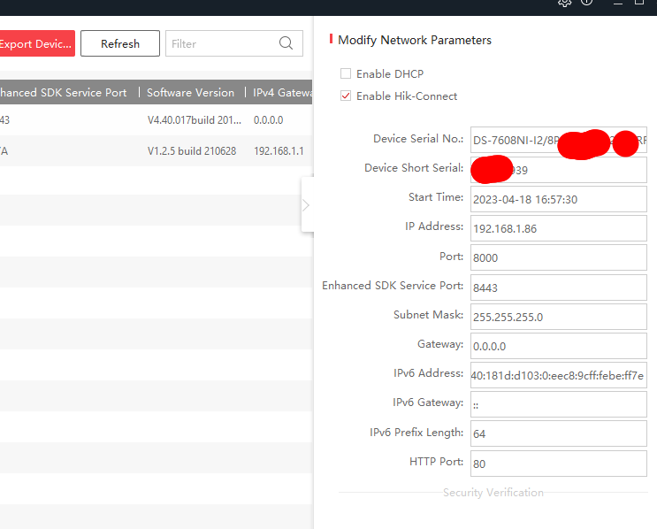

001 setting:
002 setting:
Note that both has 'DHCP' disabled.
As I said, I can connect SADP and I am able to read this information from my computer connected to the POE switch. But when I tried to access the NVR through the browser by typing the following ip addresses, all I get is this address cannot be reached. I made to sure to switch off my wifi so my computer is only connected to this LAN. Addresses tried:
- 192.168.1.86
- 192.168.1.86:8000
- 192.168.1.86:80
- 192.168.1.64 (this is the poe)
I don't know if this is related to the DHCP setting? As I suspect my computer does not get allocated an IP address on this LAN upon connection. I could not modify the POE switch to DHCP because I do not have the password - we inherited this system from the previous owner who lost all those...

First of all, the issue with accessing the device via a browser is likely to do with the network settings of the devices.
I assume that if you have recently moved into the property you probably set up your ISP (Internet Service Provider) that was likely different to what the previous owner used. Sometimes when you change the ISP they give you a different router/gateway IP address and this might not match the IP address set on the Hikvision devices (e.g. the switch and NVR are currently 192.168.1.xxx but the router address range could be 192.168.2.xxx or 192.168.5.xxx).
We would recommend following these instructions to use Command Prompt to check the IP range of your local network and see if it is 192.168.1.xxx or something different.
