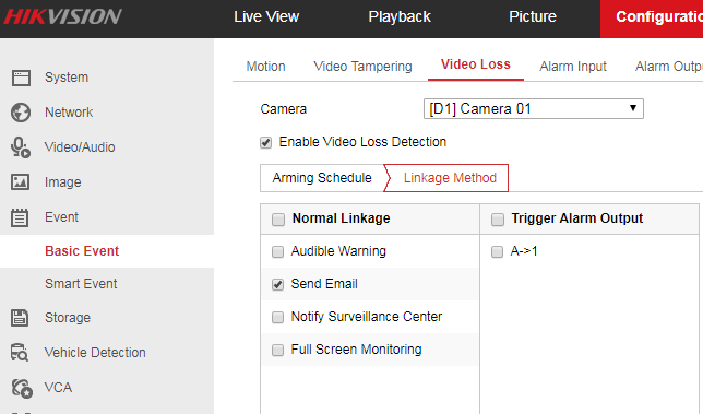

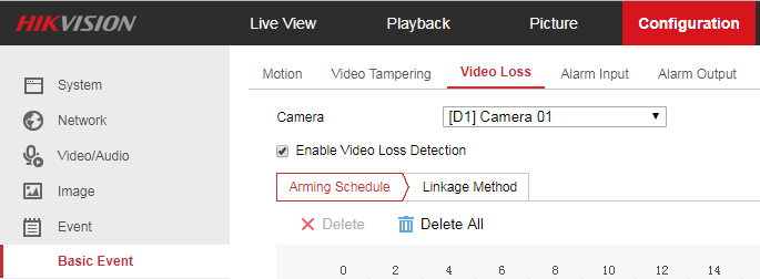

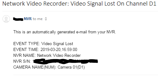

If your NVR supports the feature, you could enable Video Loss Detection and have an alert sent to your email. It works for both interruptions in power and stream loss. I've never tried to integrate this alert into iVMS-4200 but it should possible.

Thanks for the hit up this option ilike what u mention it will send a pop up and log when video is Dc or camera down..
does not notify if the camera stopped recording.
