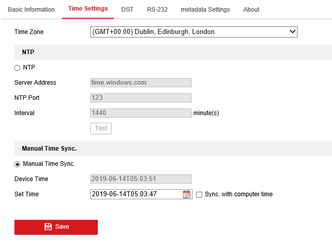

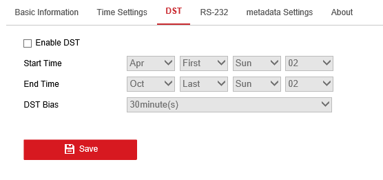

Are there any recommended settings for the UK, handling DST too?

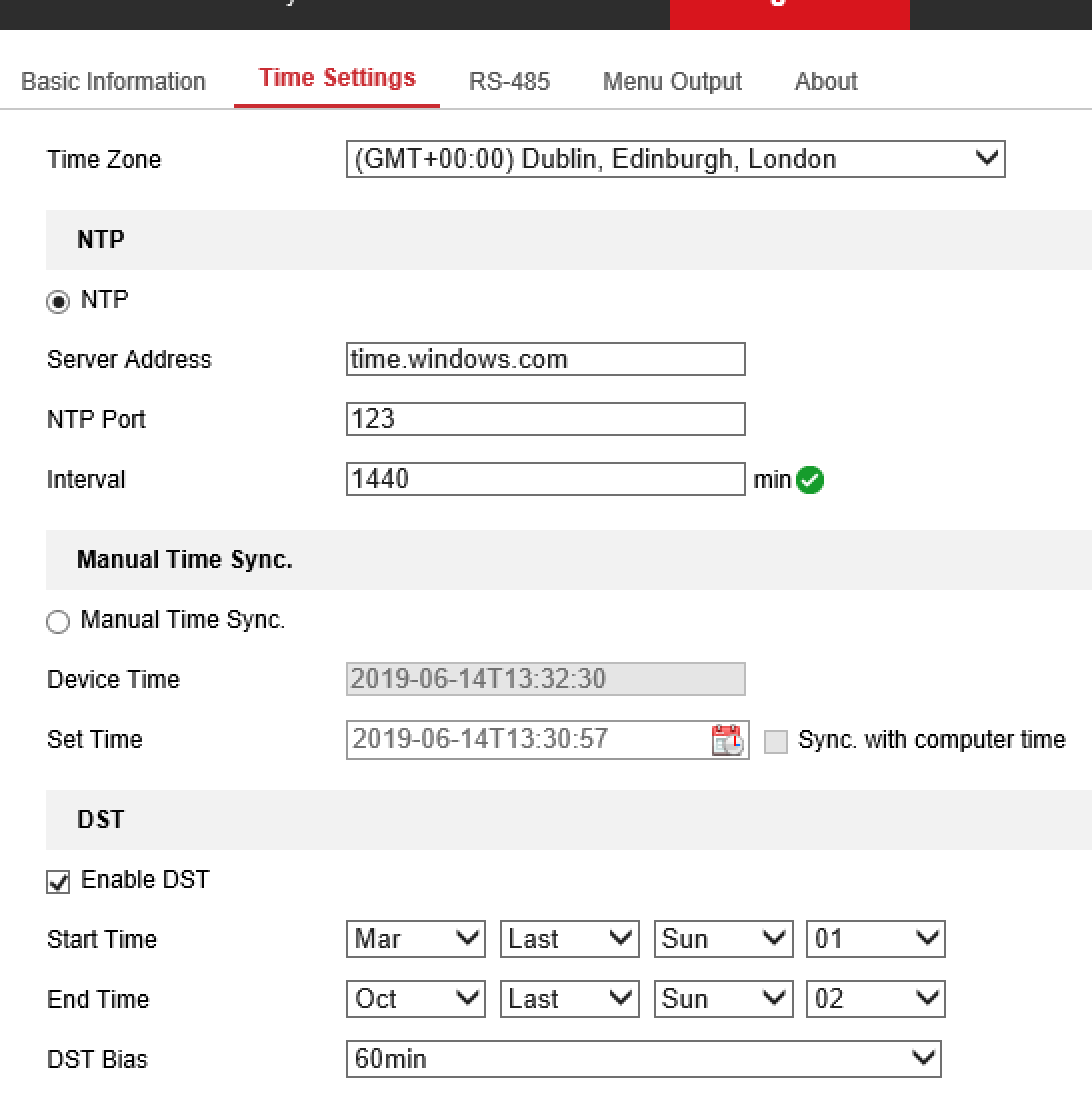

Yeah was wondering about the DST, you have 02 whilst i have 01. Do the settings use the non DST time, if so then 01 will be correct, if they use the DST time then 02 will be correct.

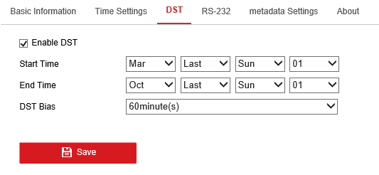

Yeah forward 1hr at 1am GMT and back 1hr at 2am BST (1am GMT), so for the end time is it 01 or 02? Both GMT for start/end would make more sense so it would be 01.
I think those are the official times that UK DST changes, I have always setup my DST that way. Its a habit from working in global operations......
