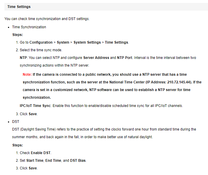

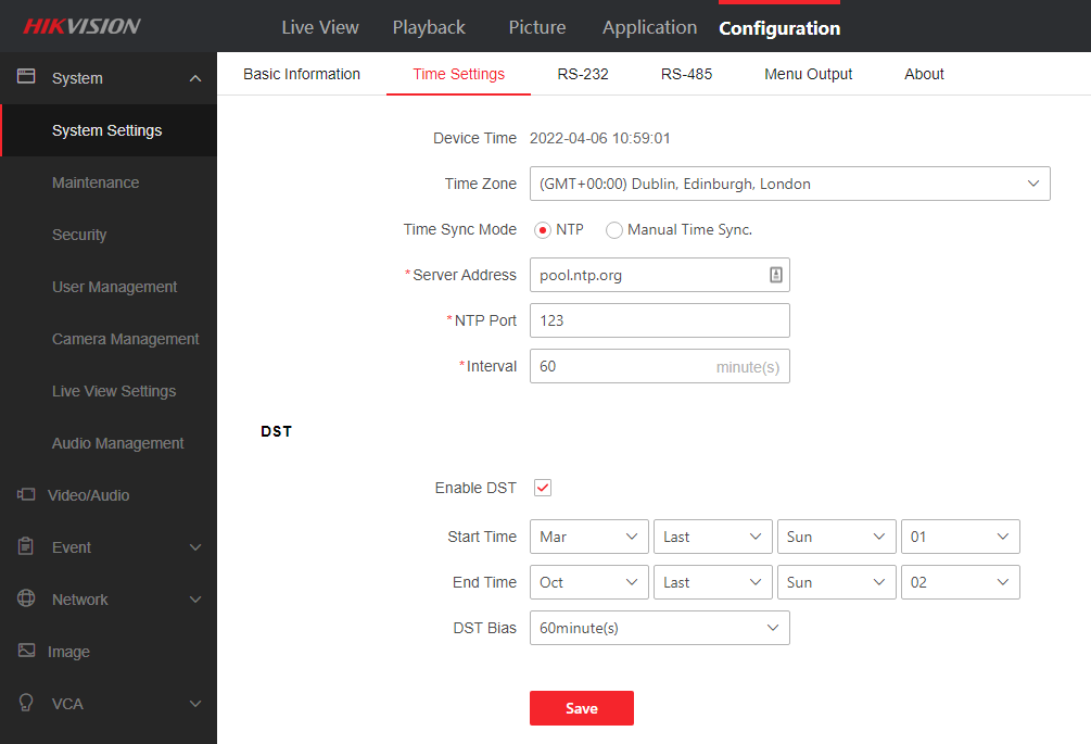

V Vauxfan Gives a lot of help Trusted Member Messages 283 Points 18 Apr 5, 2022 #1 DS-7608NI-I2 how do I set the time to read correctly now the clocks moved forward 1 hr?
Phil Administrator Staff member Messages 5,133 Points 113 Apr 6, 2022 #2 The correct setup is pretty straight forward, please see the below attachments. Attachments Time settings contextual help 6-4-22.png 18.6 KB · Views: 101 NVR Time Settings 6-4-22.png 39.1 KB · Views: 110
V Vauxfan Gives a lot of help Trusted Member Messages 283 Points 18 Apr 6, 2022 Thread starter #3 It was already on NTP. I ended up syncing time from my computer and then re enabling NTP
