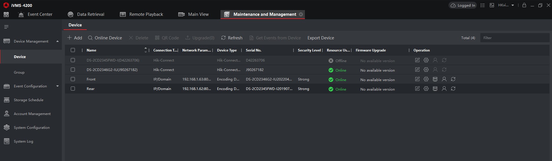

I use Windows 10. Cameras recently re-loaded themselves on iVMS4200; doesn't look right (see attached picture)
Thanks, M

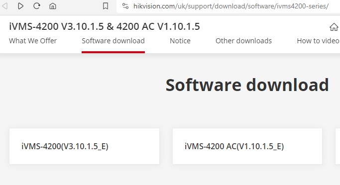

Thanks. The one on the left of this page?
