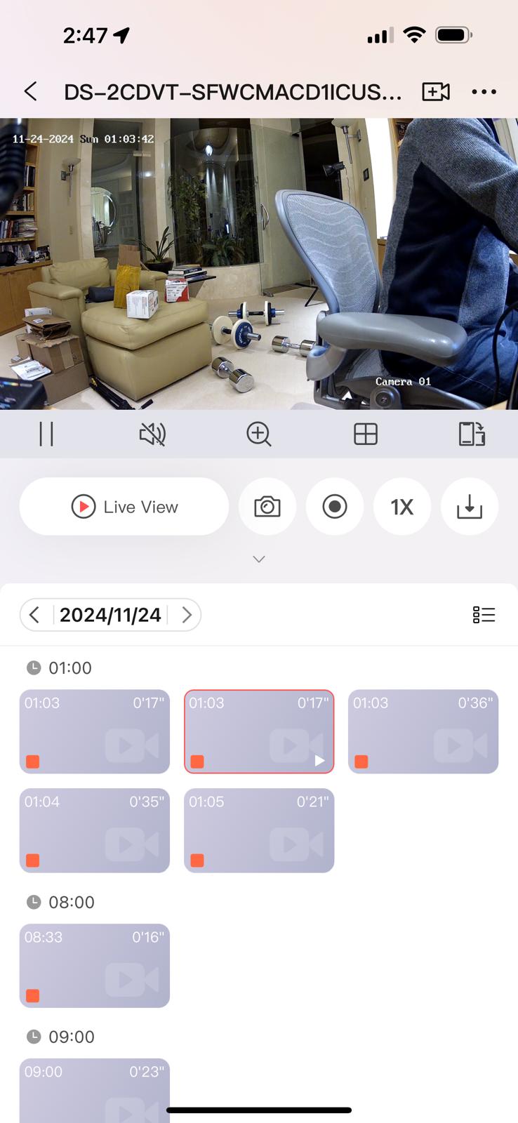

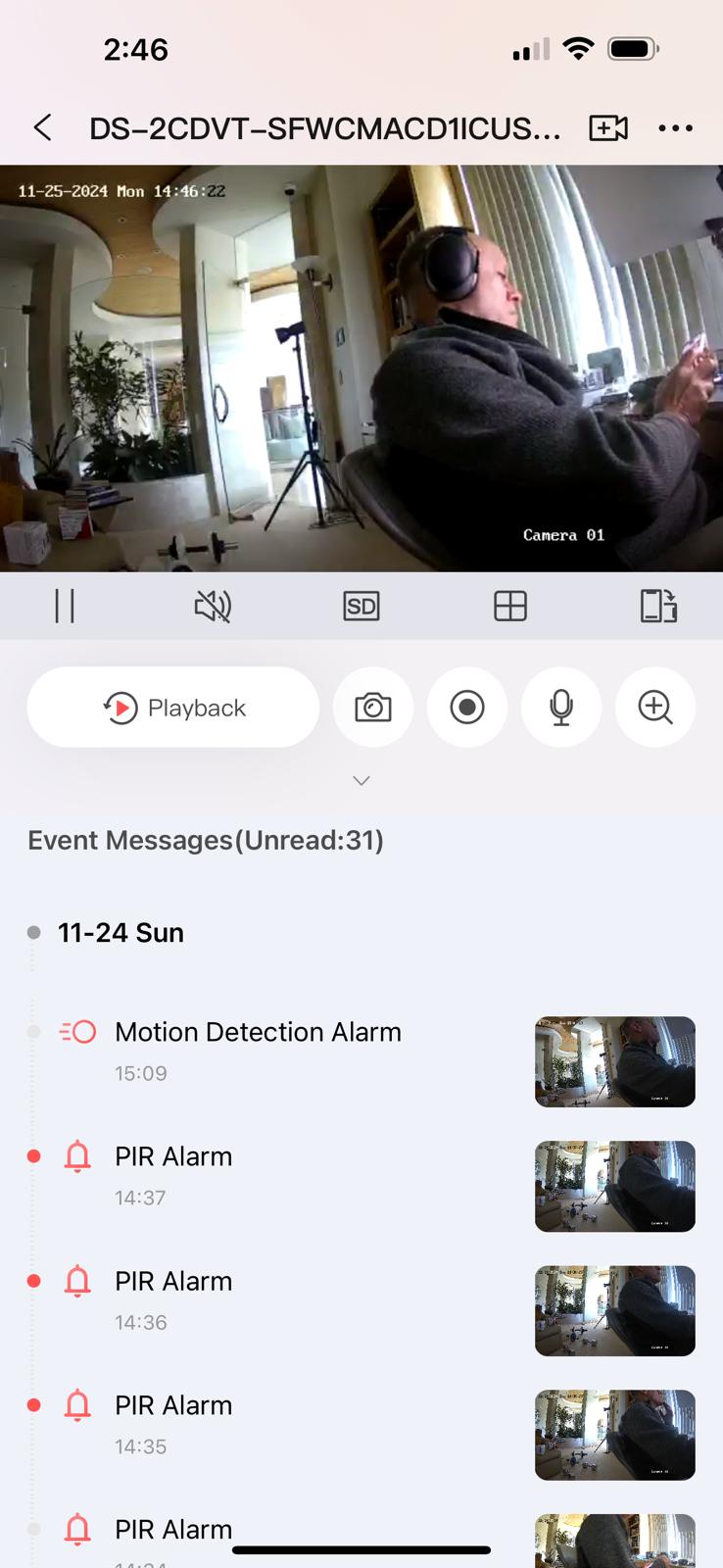

1. Thumbnails are empty in Hik-Connect, but the notification thumbnails are fine. The thumbnails are generated in the camera, so why would they work for notifications but not for the recordings? I've tried viewing on 2 different iphones, one with a fresh install of the latest hik-connect app. There seems to be no setting for this. I have SSH access to the box... is there a way to look around? Hikvision seems to make the SD cards rather unreadable if inserted in a PC, but I haven't pursued this. It appears that there is no known fix... is the problem in the firmware? It seems an easy thing would be to "upgrade" to an earlier release when this first broke... Did it break in the app or the firmware?

Thumbnails on the Playback on the iPhone on Hik-Connect

Here you can see the playback thumbnails are blank, but notification thumbnails are fine.
OK that makes sense now. I've never used those thumbnails but they're blank on mine too so I guess that's broke. They don't work for any of my camera models connected via the NVR.
