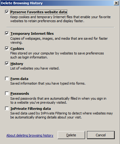

Keen to hear more about this. Are the eight channel NVRs on the latest firmware? Is this a recent development, by that I mean did the eight channel NVRs always have this issue with IE? Out of interest, have you tried clearing the cache on IE then try to reconnect (don't restart the 8ch NVRs). Keep us posted.

I haven't previously tried your suggestion, but shall do.
