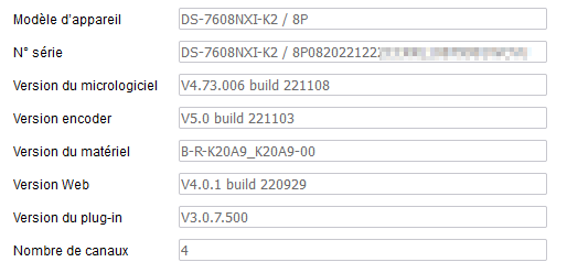

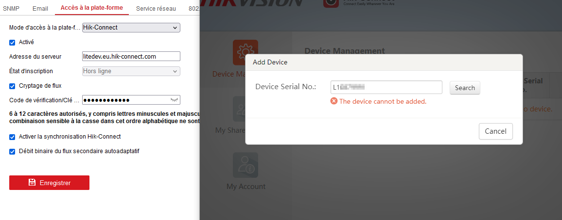

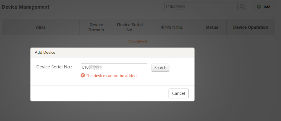

Hello everyone,
Trying to setup hik connect:
DS-7608NXI-K2 / 8P
4x DS-2CD2147G2
static ip
When i try to add the NVR on hikconnect website it says "the device cannot be added". I tried look on forum/internet/reddit there is no mention of this.
Have you guys encouter the same problem? How to fix it? Is it not better to build a DIY solution with homeassistant/motion eye?
Thanks!

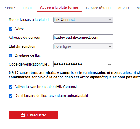

Hi Dan, thanks for your answer,
I've followed the guide but i'm stuck on part 1 :D
The hik-connect service is ON but service is offline
I have static IP behind firewall, i even tried with a allow all on the interface without any improvement..
What i found is that when i connect in SSH to the nvr, i can't ping my gateway, i suspect some internal iptables rules to block the traffic, but i can't the iptables cmd as it says "not supported" how do you unblock it?

Hi @Martel
Was platform access already enabled when you first looked at it or did you enable it after I linked you to the above steps?
If you have just enabled it, could you please try adding it to the Hik-Connect Portal again?
Hi @Martel
I enabled it
Just retried with same issue "the device can't be added"

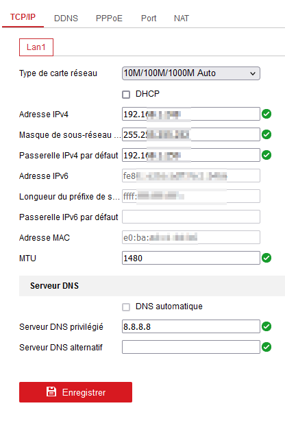

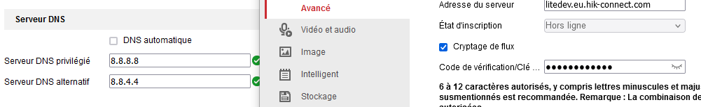

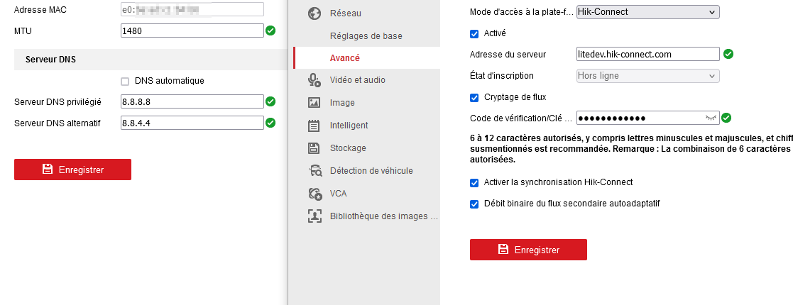

Thanks @Martel
We can see in your network settings that you only have one DNS server set, can you please add 8.8.4.4 as the Alternate DNS?
If it is still showing as offline after you save that DNS setting, can you try changing the DNS to Auto DNS and check platform access again.

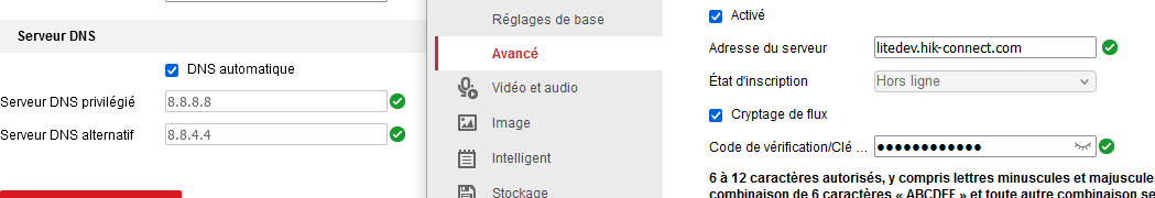

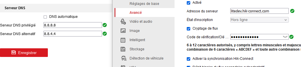

Thanks @Martel
Thanks,
Still same with 8.8.4.4
No luck with auto dns

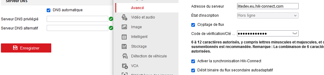

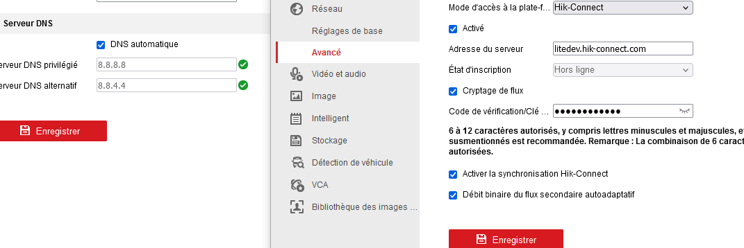

Okay,
Can you try changing the Hik-Connect Server Address to litedev.hik-connect.com
Okay,
Tried both with static DNS and autodns and still offline,

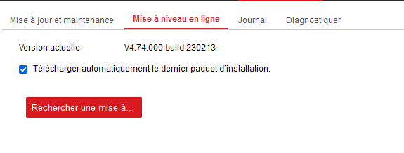

Thanks @Martel
Can you please try updating the NVR firmware to the latest version - V4.74.000_230213? Once updated, please check the Platform Access page again.
Same issue after upgrading :(
Tried both auto dns / static

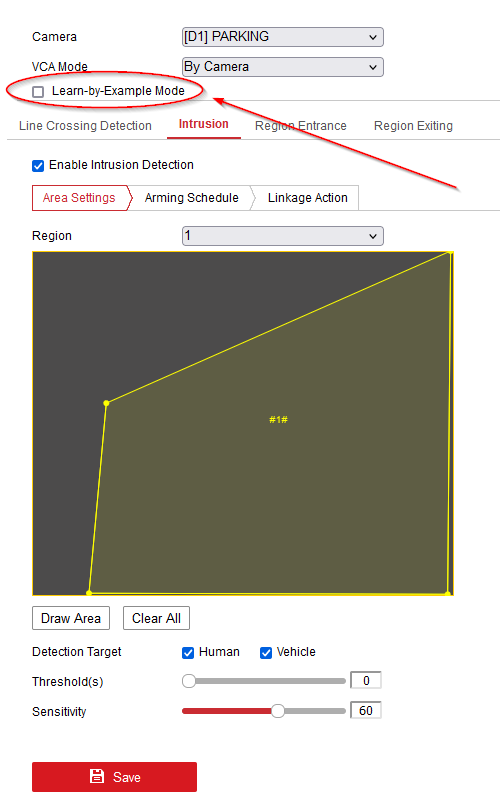

2/ On the storage part, i've setup recording on intrusion only, all other events (motion detection and all zone in/out/line are off) from monday to sunday /24h
Should i tick the box for "Learn by exemple mode" (on the screen) ?
