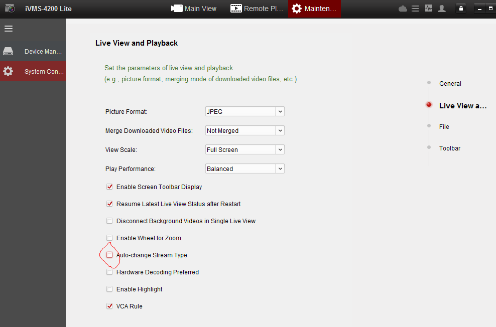

In iVMS-4200 lite, click Maintenance at the top. Under System Configuration>Live View and Playback make sure Auto-change Stream Type is NOT selected.

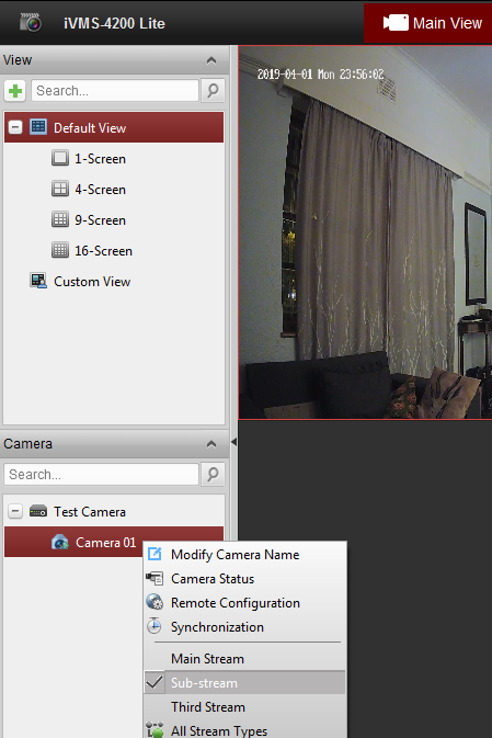

Then back in the Main View tab right click the camera and you will be able to select the stream type. Keep us posted.

Ah! Thank you very for your help. That makes perfect sense.
