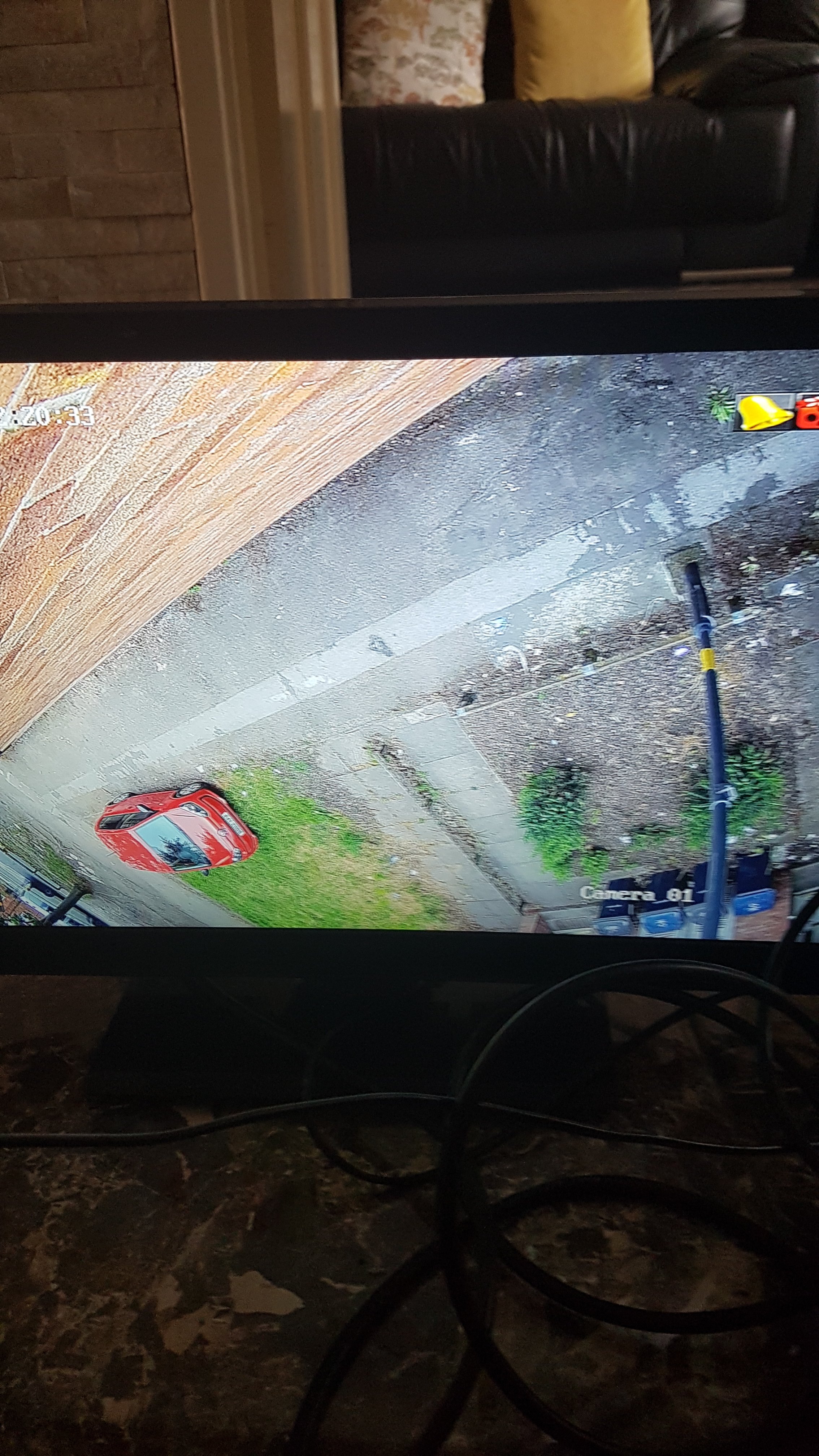

Just bought the hikvision NVR and two ptz mini cameras and I cannot get it to work on my pc or use ivms 4200 on the ivms 4200 I can only see my NVR connect but I cannot add any cameras it says not recognised but the cameras are online. However when I connect the HDMI to my TV I can see the cameras working but I cannot get it to work on my computer. I know that the cameras are working but I can't get it to work on my computer to set any features such as auto tracking someone please help me.

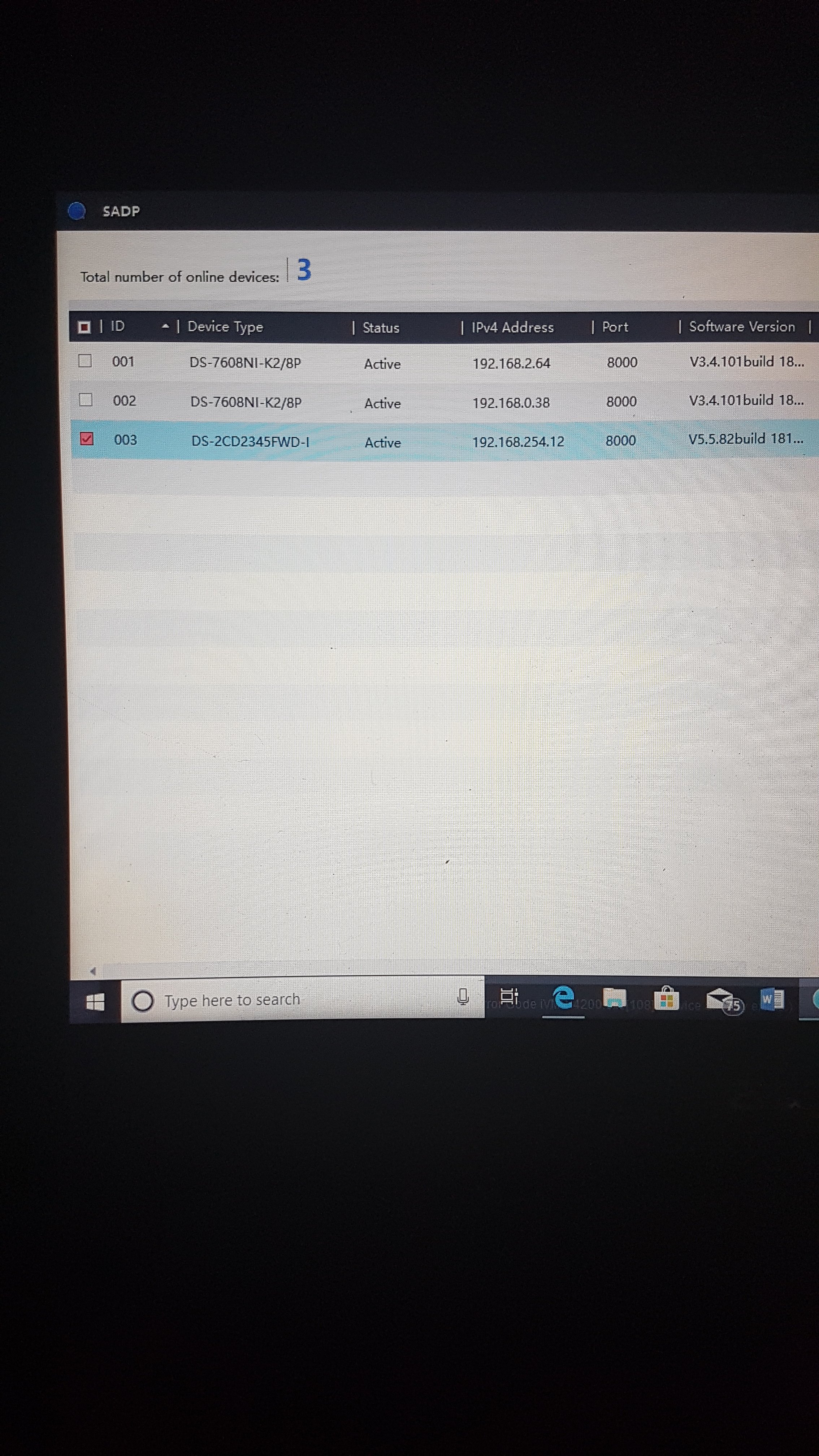

Image 3 - SADP - 2x NVRs - different domain ranges?
Internet Explorer is your friend - can you access the NVR(s) using IE at the IP address shown?

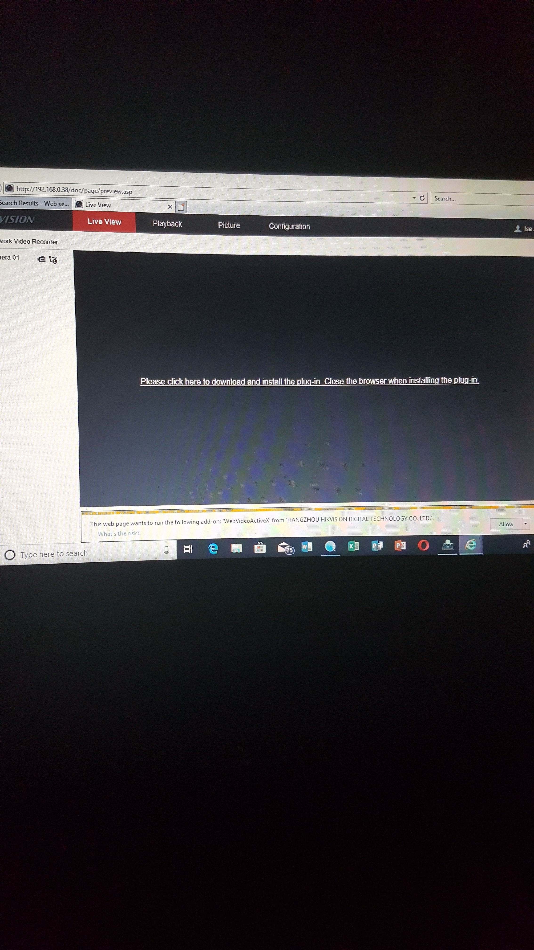

I can access the ip address 192.168.0.38 and it take me to hikvision login page and I can login in however there is a camera connected but I can't see the live veiw

Are you using Microsoft's Internet Explorer browser?
Have you installed the web components plugin?
It will not work with the Microsoft Edge browser.

Ok so if I use Chrome and do what you said can it work and what about the cameras ip address which is not working
Please, use Internet Explorer - first.
It is possible to use the Chrome browser, but you will need to install the IEtab extension (to emulate Internet Explorer).

Go to the Start bar search box, just type "internet" and the IE shortcut icon will appear
