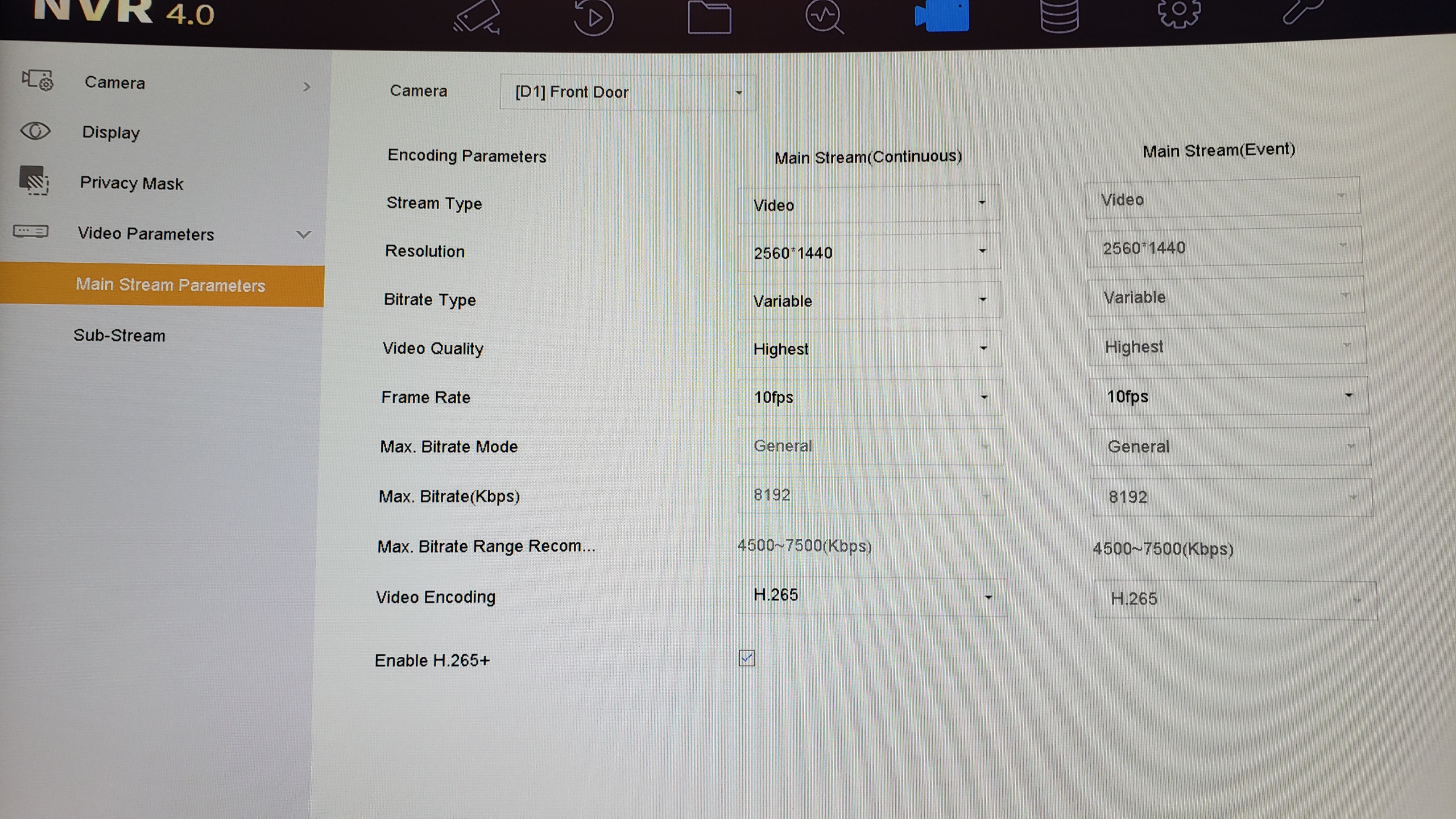

As to where I see the recommendations, when I go to "configuration" and "Video" there is a page that allows me to set all the video parameters such as fps, video quality, etc. That is the page where I see the setting for max bitrate. Just below those settings is a line that says "recommended max bitrate" with a number next to it. That recommended number is a range, e.g. 7,500 - 9,500, and changes according to what I've set for fps, video quality, etc. So for example if I change video quality from "highest" to "medium" and hit save, the "recommended max bitrate" number changes to a lower number, and vice versa.
That's where part of the problem lies. Based on the settings I've established for each camera, the recommended max bitrate as stated by the NVR is a much higher number than what is being reported as the setting for "max bitrate" - a number than I currently cannot change.
I have no idea if the recommended max bitrate takes into account I'm using 265+. I see nothing about this in the user manual.

Phil, here is the screenshot we discussed. This is from the monitor on the NVR. As you can see, the third from the bottom shows max recommended bitrate. The weird thing is that after rebooting the NVR, cam 1 allowed the change to the higher bitrate but cams 2-5 did not.
Do you have the same issue when only 3 of the cameras are connected to the NVR? I'm wondering if this might be a decoding capability limitation on the NVR.
