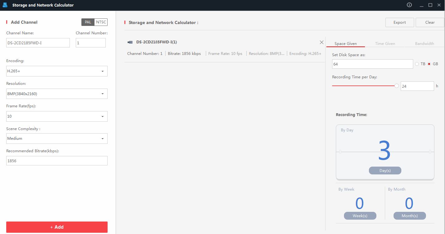

According to Hikvision's Storage and Network calculator app, three days is about right.

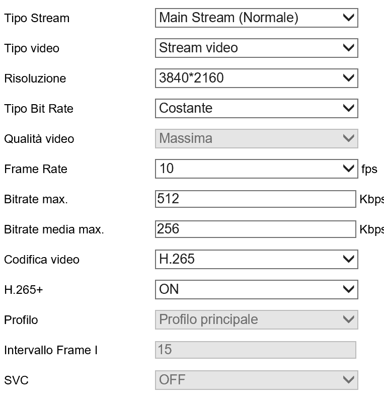

this is the configuration I used for DS-2CD2185FWD-I (sorry if it's in local Language)

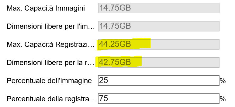

and what I see in the menu related to the archive. In 2h it wrote 7.5GB (so 3.75GB per hour)
2112

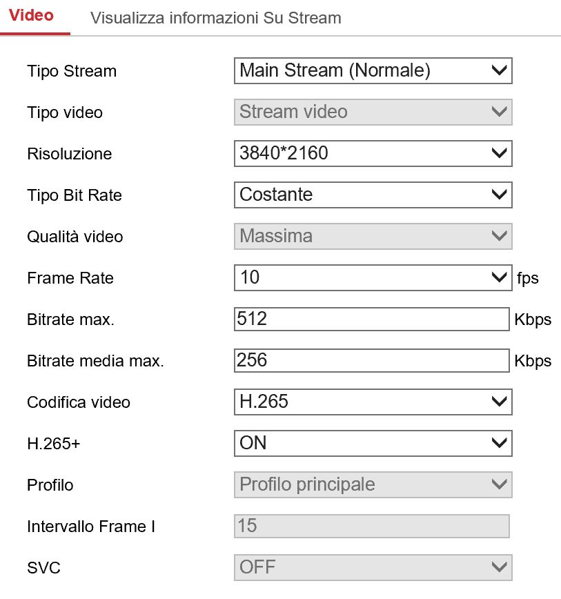

Here you can see the configuration I used for DS-2CD2785FWD-IZS. As you can notice they are exactly the same
2113

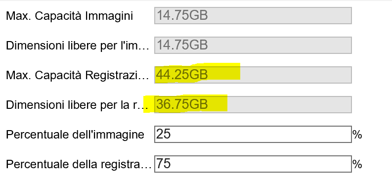

and here the archive menu. in 2h tit used 1.5GB (so 0.75GB per hour)
2114
So we have DS-2CD2785FWD-IZS using 0.75GB per hour and DS-2CD2185FWD-I using 3.75GB per hour (i've 4 of them same behaviour).

What I get with the DS-2CD2785FWD-IZS is inline with what Hikvision calculator shows. It's 0.75GB x 24hrs=18GB per day. In 3 days the amount of space is 54GB (the tool estimates 64GB but it's just an esimation. the magniture is correct).

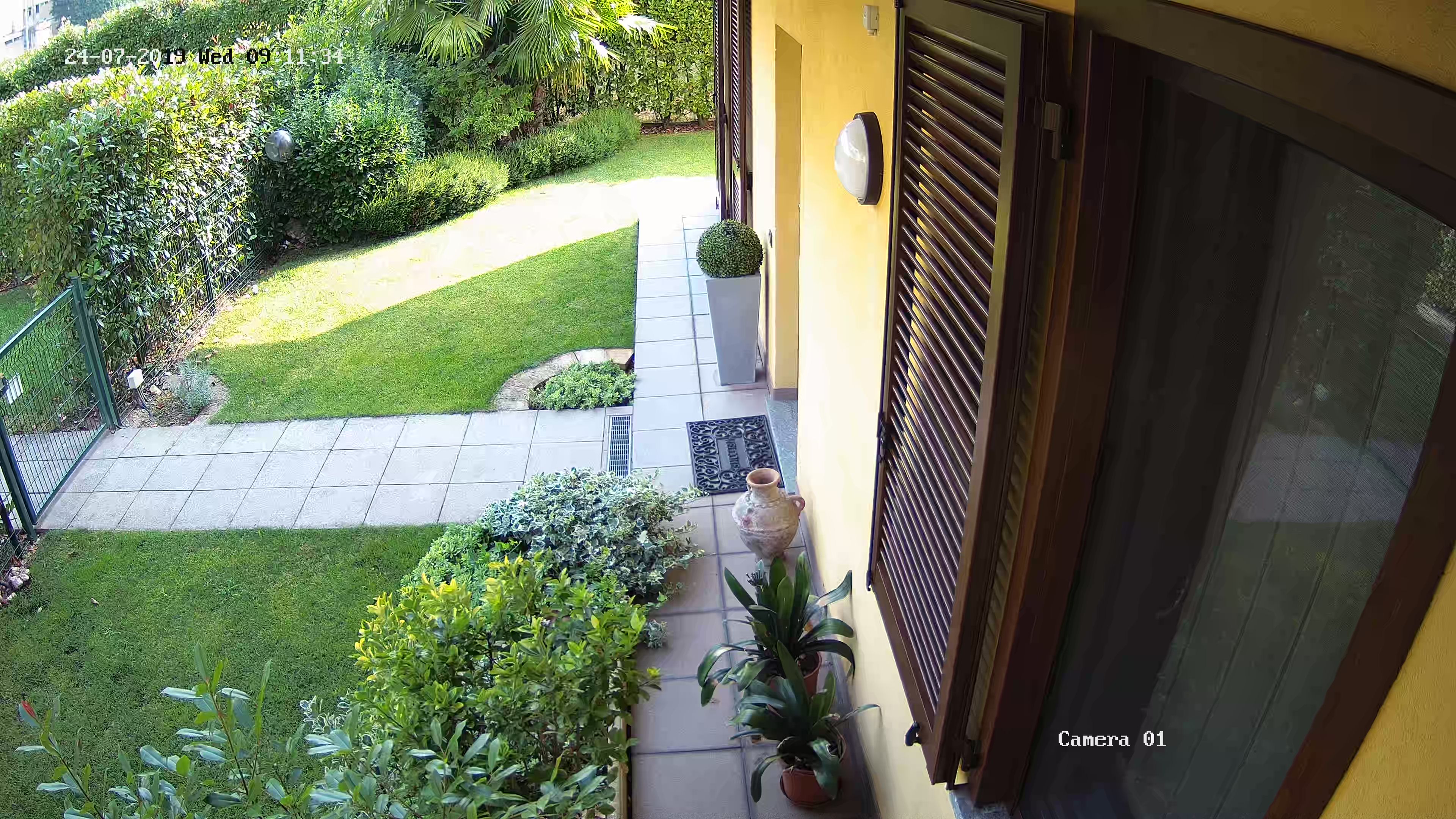

Please provide the lens mm on the fixed DS-2CD2185FWD-I cameras and the focal length of the DS-2CD2785FWD-IZS. It would also help if you attached an screen capture of one of the DS-2CD2185FWD-I cameras and the DS-2CD2785FWD-IZS.

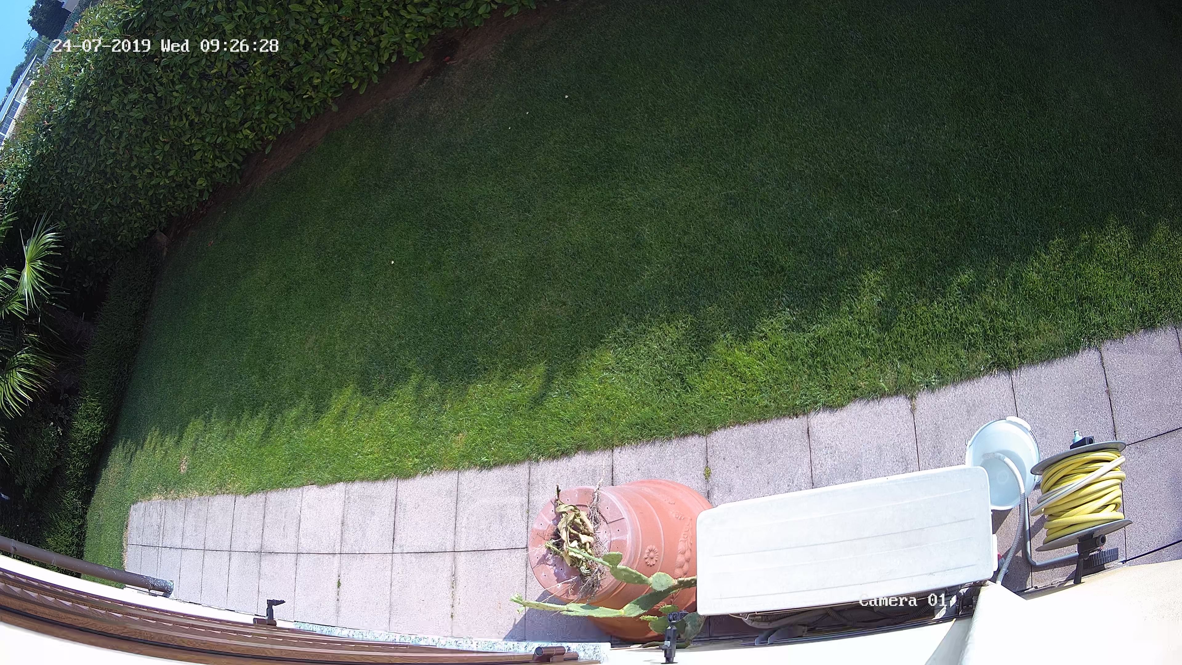

Hi, the fixed DS-2CD2185FWD-I cameras are 2.8mm. The DS-2CD2785FWD-IZS is a varifocal and I configured it "closing" a bit the lens, like it was a 4mm.
I took a picture in different moments of the day (so with different sun and shadows). The files are all 3840x2160 with 96dpi and 24 bit depth.
- The fixed DS-2CD2185FWD-I generates a file which is between 1.7MB and 2MB (it depends on the moment of the day)
- The DS-2CD2785FWD-IZS generates a file which is around 1.37MB.
In the worst case scenario (1.37MB Vs 2MB) the difference is 30%.
I attach a sample
Note: I record with constant bitrate on both cameras (I also tried with variable but nothing changes). Based on my tests DS-2CD2785FWD-IZS records 0.75GB per hour. This is inline with what Hikvision calculator shows. It's 0.75GB x 24hrs=18GB per day. In 3 days the amount of space is 54GB (the tool estimates 64GB but it's just an estimation. the magniture is correct).
DS-2CD2185FWD consumes 3.75GB per hour which is lot more (5.5 times bigger). Considering that a single frame of the video is "just" 30% bigger, why the overall result is 550% bigger?
thanks a lot in advance
mc

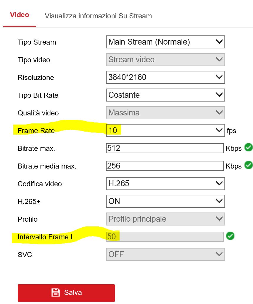

I will play around with the settings you suggested. Just a very basic question: The I-Frame interval is greyed out, any idea on how to change it?
That's interesting. I recall having the option to change the I-Frame interval when using H265+ but you're right, it's greyed out on my camera too. The help documentation confirms its unchangeable when using H265+. Maybe in an earlier version of the firmware? I'll look into it.
Hi StewartM, I realized that using H265+ the I-Frame interval is automatically managed by the camera (this was described in a post from Phil).
