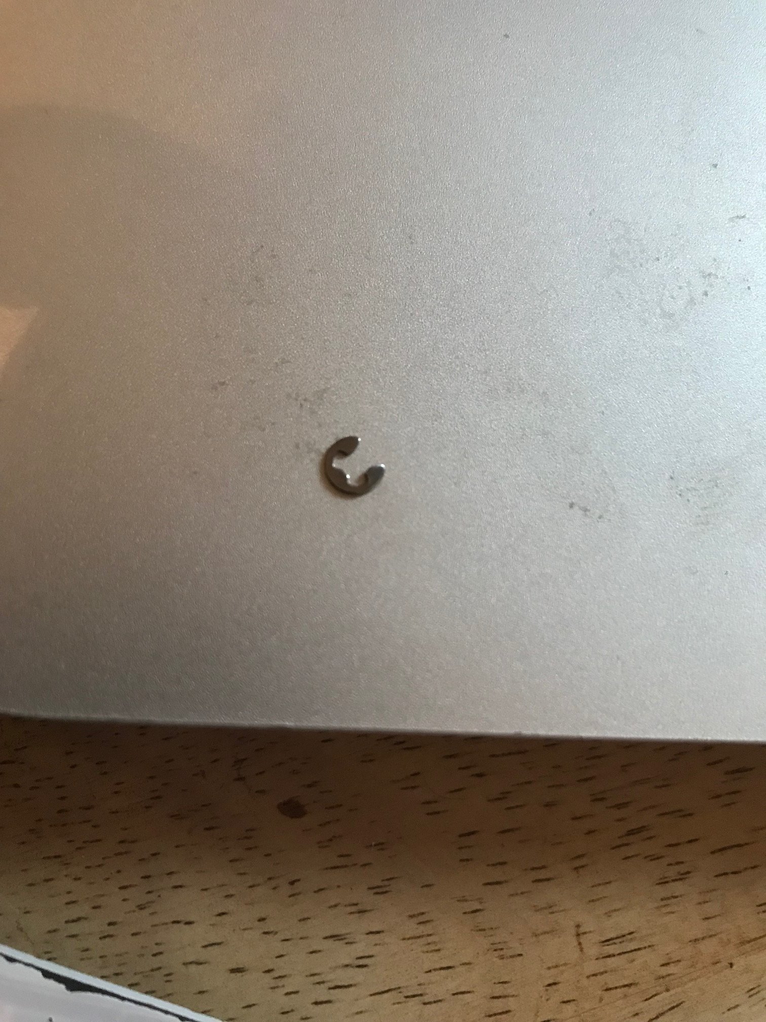

Small metal Washer found whilst disassembling a 2385
Jamo
16
As I was installing an SD card into my turret 2385 I have found this washer type thing, where about does it go?
Thanks!

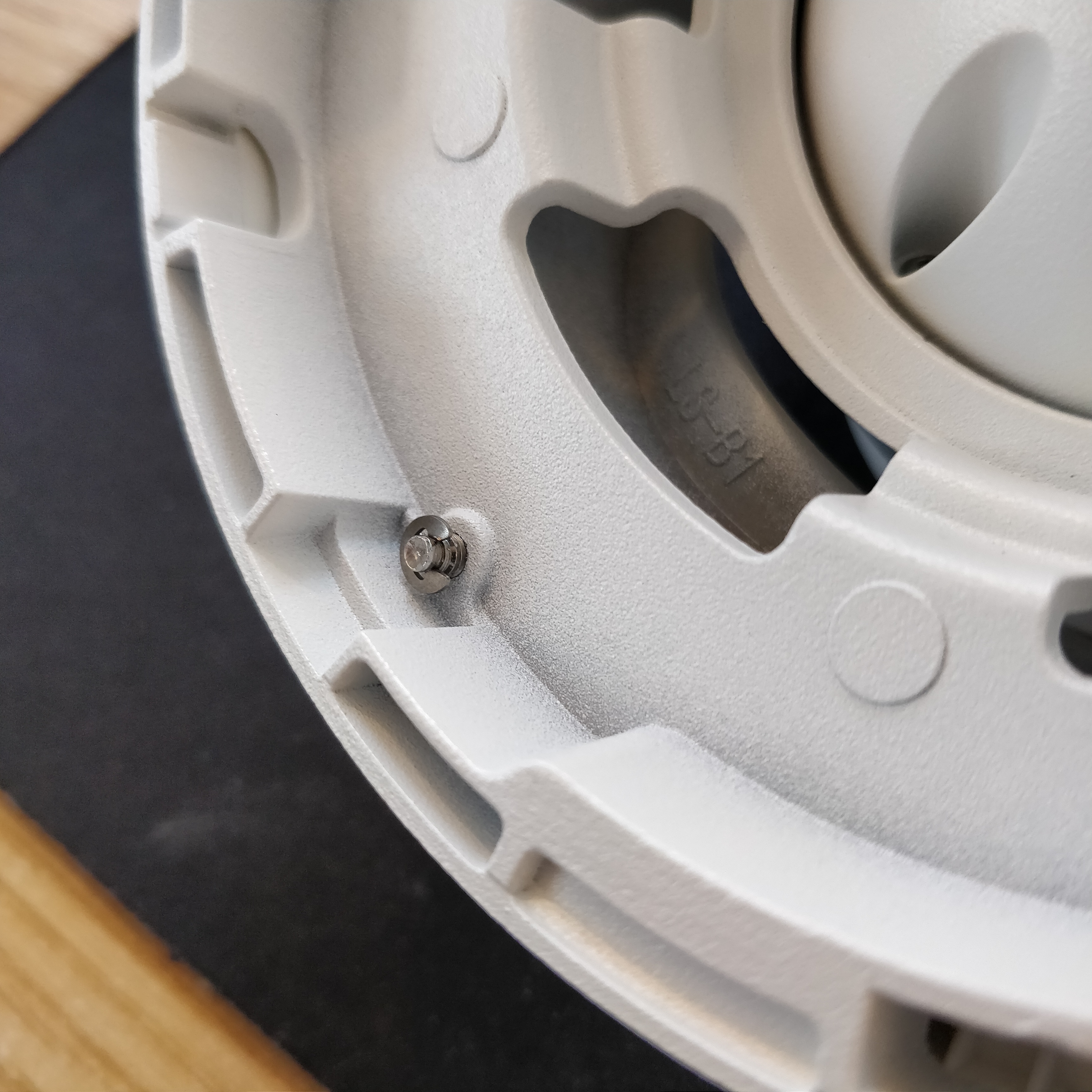

Hi @Jamo
That washer attaches to the locking screw on the underside of the camera (see photo below), it's meant to stop you from unscrewing the locking screw completely but some people like to be able to remove this screw so if it is too fiddly to reattach it you can just leave the screw without the washer.
What it looks like to me: on the mounting base plate there is a small screw that secures the camera housing. On the back of that screw is a c clip that prevents the screw from being fully unscrewed.
Edit - treed by Dan!
Thank you fellas, that makes a lot of sense, cheers!
