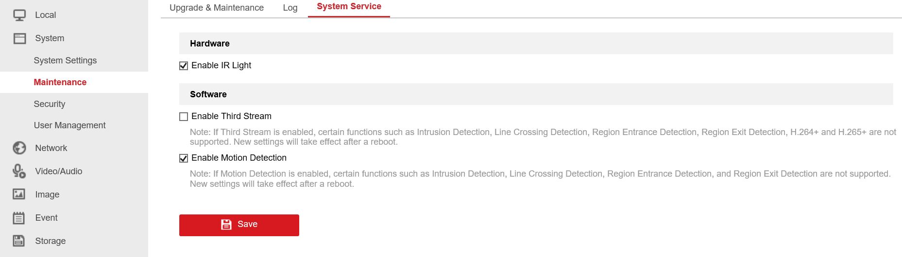

  • System > Maintenance > System Service and under the software section, > Enable Motion Detection first then complete the above steps 1 and 2. I am wondering if anyone else has seen this or if I am loosing my mind..

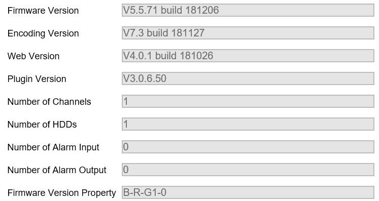

Camera Firmware - this is a US market camera.

Did it ship with that firmware, or did you update it to that version yourself?
For the EasyIP 3.0 cameras firmware versions .70 and .71 were pulled due to issues arising.
We were recommended to propose .63, but .64 seems fine too.
Hi Phil - thanks for your reply. The camera did ship with that firmware.
I suspect this is the new way to enable Motion Record as it relates to other features in "AcuSense" features. Here is a clearer view of that text. These features must be have deeper pinnings in the new firmware. Even requires a reboot. Makes sense as motion detection is pretty far away from that other features that are similar. I hope it makes them all work more acusenseably... :-).
"Note: If Motion Detection is enabled, certain functions such as Intrusion Detection, Line Crossing Detection, Region Entrance Detection, and Region Exit Detection are not supported. New settings will take effect after a reboot."
