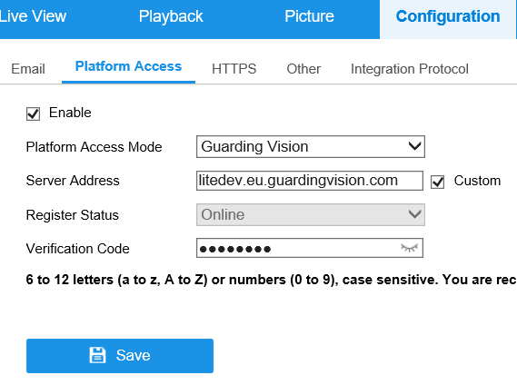

Despite all the wonderful guides available here and the plethora of support articles and videos provided by Hikvision, I've been struggling to get remote access to my new DVR and cameras. It's a DVR-204Q-K1. I initially tried using iVMS-4500 with port forwarding rules on my router. All the rules bar one worked. I could never get the port 443 rule to work - it always gave me "connection refused". iVMS-4500 worked fine internally but I could never get it to work external to my network.

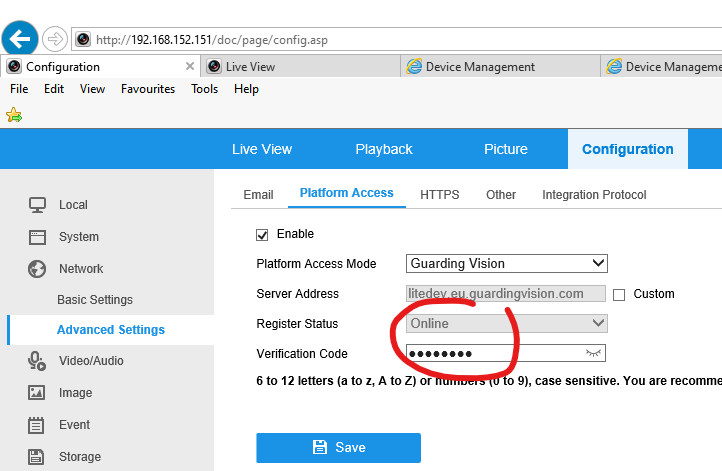

I then read that Hik-Connect didn't need port forwarding (?) so I tried that. Whilst again that worked internally I couldn't get it to connect externally. In setting that up, the instructions advised setting the Platform Access Mode on the DVR to Hik-Connect. That option wasn't available to me. The only option on the drop-down menu was Guarding Vision. I believe though that this has been set up correctly? See screenshot -it's showing online.

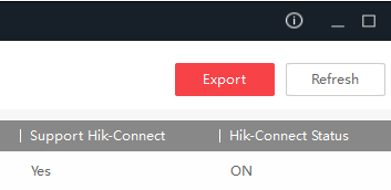

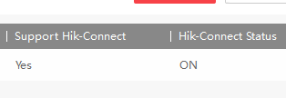

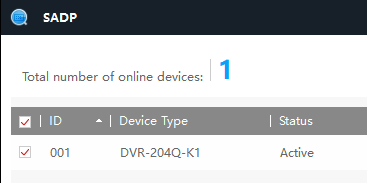

I can't recall now where I saw it but there was a link somewhere that you could put in your DVR model number to check if it was Hik-Connect compatible - mines was. Also SADP shows...
If I ignore the Guarding Vision PAM and put the Hik-Connect server name in it never shows as online.

So, I understood that once I'd established my DVR's IP address using DHCP, if I then made that address static I could remove the tick from the TCP/IP DHCP box. Turns out not. Adding that back in enabled remote access via Guarding Vision. Sorted.

As per original post a Hik-connect option isn't available to me in the Platform Access Mode drop down. However if I put a Hik-connect server address in anyway and click custom it never shows as online ( whereas the GV address does).

It's frustrating when my NVR is telling me it can see and is connected to the Guarding Vision site- see below.

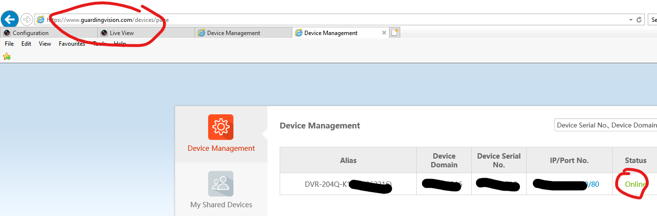

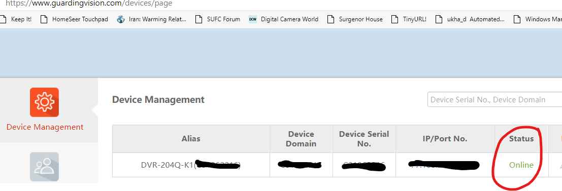

...and that the GuardingVision.com site, when I logon (externally), is telling me it can see my NVR.
I struggle to understand why the apps (either Guarding Vision; Hik-Connect or HiLook) can't connect.
