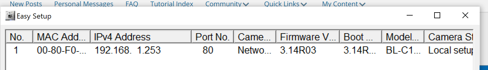

Step 1 is a search for cameras. Camera is found as in Screen 1 (attached). only one shown but I have tried two hence the two shown in Screen 3.

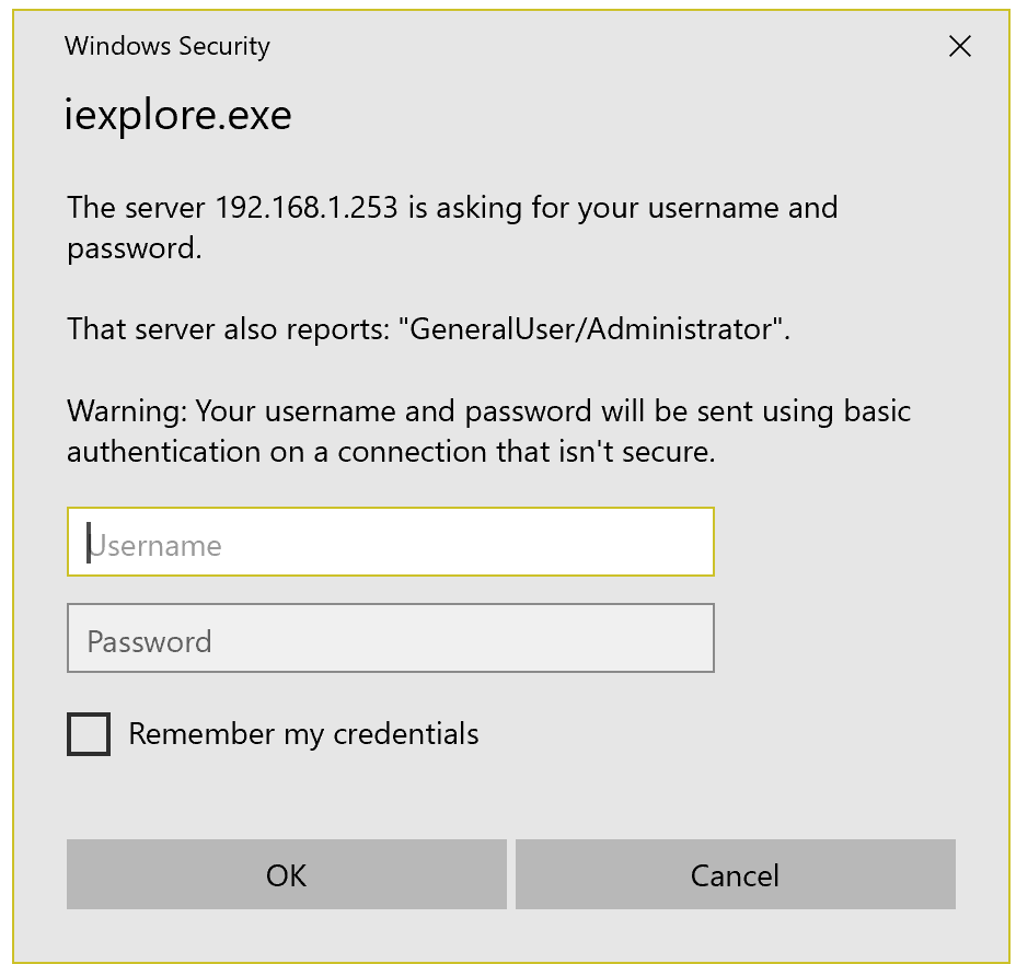

Step 3 is where I get stuck - see Screen 2 attached.
No matter what Id and Pw I use, it fails with no error message - just goes back to the same Id & Pw screen.

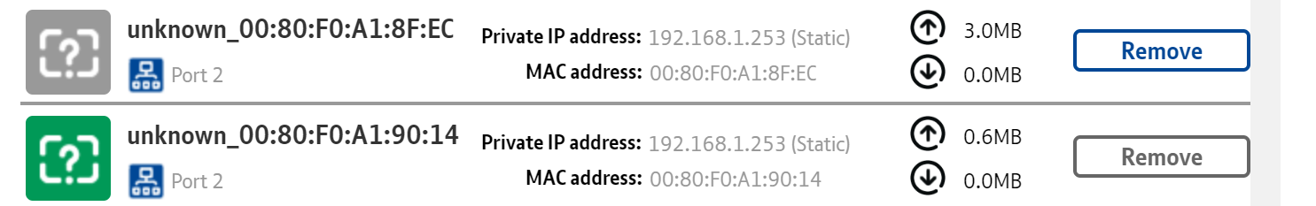

Logging in to the modem (British Telecom standard issue) using its IP address I can see the camera listed amongst the devices (Screen 3). All other devices show (DHCP) after the IP address. These two show Static.

I'm not sure the problem is the camera. As screen 2 shows, it is trying to connect with my modem. I can access the modem on the admin address of 192.168.1.254 using my Id and my Pw but using these with address of the camera does nothing.
Unfortunately I am not at all knowledgeable on networking but it seems to me that the camera defaults to an IP address (192.168.1.253) and expects that to have an Id and Pw which to me seems odd. There are various things on my LAN all with their own IP address but none of them (as far as I know) don't need an Id and Pw.
There is also the question of all other devices showing DHCP next to the IP address but this one show Static.

The Panasonic default settings used to be:
Username: admin
Password: 12345
Does this help?
I'll try those - thanks.
Unfortunately the default id and Pw didn't work. I had tried blank ones.
