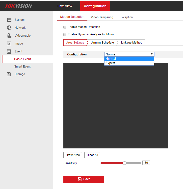

You may need to select Expert mode.

Thanks for the reply. It's the Smart Event i'm using, i'll see if I have Expert mode under Basic.

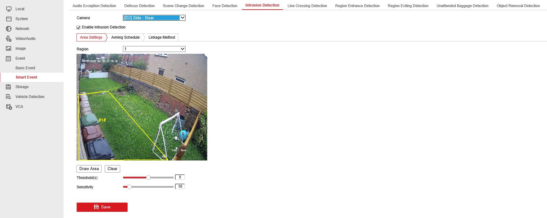

Is that your NVR screen, there's no camera dropdown and only a few detection tabs? My K looks like this from the NVR, doesn't seem to be clever enough to show correct options

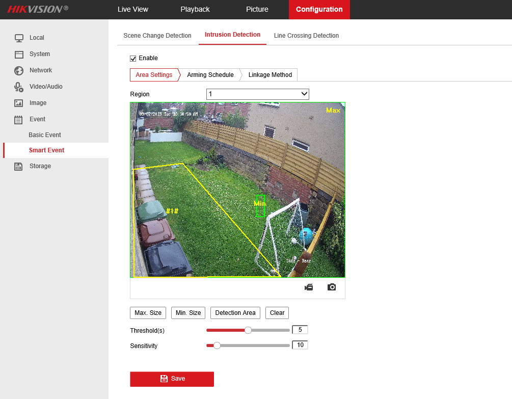

But if I go to the camera directly.....
2362
Yes, that was my NVR dropdown. I could not fit the lower part of the screen into the shot, so I had to scroll down a bit to show you the min/max size boxes. None of Hik's products seem able to handle high resolution screens.
Scrolled all the way up:
By the way, how are you getting any alarms at all with the settings you have for threshold and sensitivity? Wow.

Your threshold setting means it takes 5 seconds of activity to trigger the alarm. That's a lot. That is typically set at 0 or 1 for such a small area. Sensitivity is also usually in the 30-50 percent range. Again, this will all need some experimentation and it depends on the size of the area drawn by your box. But for example, in that small area around your trash cans, it seems one could easily walk through that box in under 5 seconds, which means no trigger. Just trying to help :)
Think about how long something moving must stay inside the yellow box in order to trigger, and you'll see why smaller boxes need a lower threshold. Ignore the threshold setting of 1 on this cam, it's for monitoring only (notice it is not enabled). I only set the boxes for when we are away on vacation and I can then enable both line and intrusion. If this were set for full time alarms like my cam above, I'd set the threshold to 2.
One last note - here is how I've generally approached setting up my line/intrusion detection on my cams.
I draw my area first. Then I set a minimum box that is just big enough to exclude insects, cats, possums, etc. Then draw the maximum box as big as the screen. I generally leave threshold at 0 or 1. Then I adjust sensitivity and see how it works. If too many false alarms not related to object size, I lower the sensitivity in increments of 5 until I get what I want. That has generally ended up with a 40-50 sensitivity. But it depends on the camera - I have a backyard camera that gets shadows of waving tree branches on a shed that will set off both intrusion and line detection in bright sunlight. Lowering sensitivity to 35 for both has eliminated the falses. It just takes a lot of time to get everything perfect.

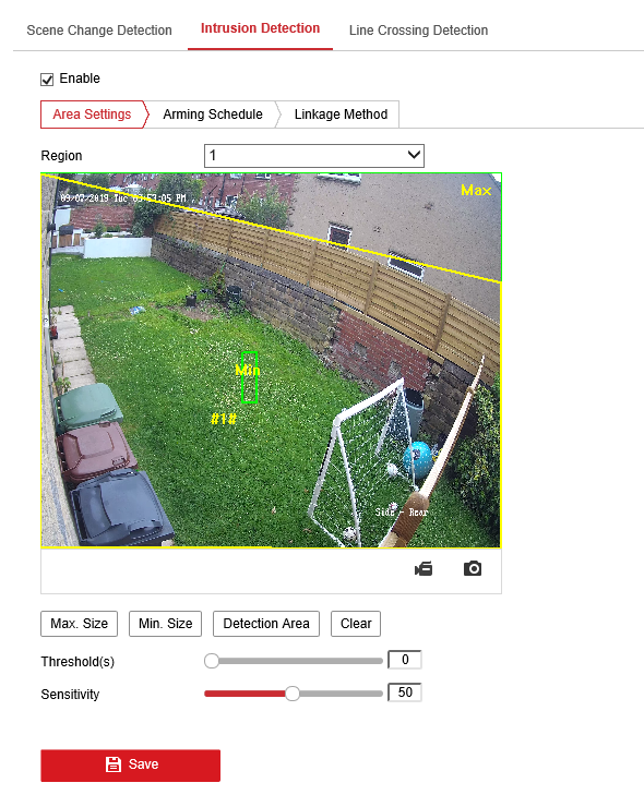

Thanks, I can't seem to trigger intrusion detection at all, got it set to below now, I can walk around the grass and it doesn't alert me, line crossing works though.
2375
Check your arming schedule and the linkage method. And make sure you hit "save" after any changes.
You may have to enlarge that min box at some point. It's going to pick up neighborhood cats, critters, and bugs flying close to the lens.
