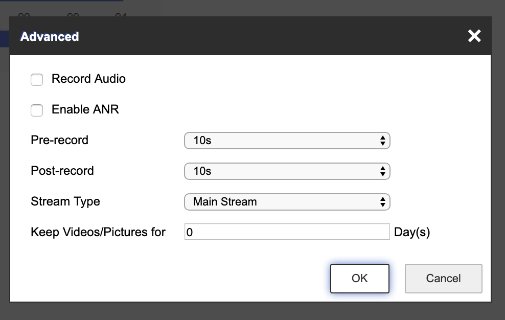

Does anyone know if Hikvision plan to build in a recording retention policy to their NVR products?
In some situations it is important to ensure data is only kept for as long as required and often covered by data retention policies.
I don't see a means for instance to remove recordings over a given number of days....
Hi @CliveC
This feature already exists, If you go to Storage > Storage Schedule > and click the Advanced button in the top corner of the schedule you will get the below pop-up with the box to choose how many days footage is held for.

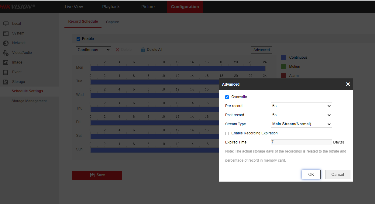

Hi Dan,
How do you set the number of days to record in this screen? I'm using a using a 250 GB memory for storage. At the moment it only records 3 days which is not really ideal
okay, the reason you are only getting 3 days of recording is because of the size of your MicroSD card.
An 8MP camera on max. settings (e.g. full 8MP resolution, Highest video quality, and 25fps) will use a lot of storage.
For example, if you wanted to record one 8MP camera continuously for 7 working days using the above settings it would require 1TB of storage.
You can try reducing some of the stream settings to get more recordings, but this will probably only get you a few extra hours. If you want days worth of extra recording you will have to upgrade to a much larger MicroSD card or purchase an NVR & 1/2TB HDD.
