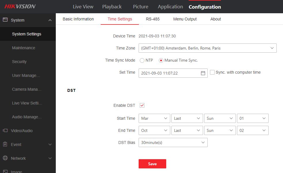

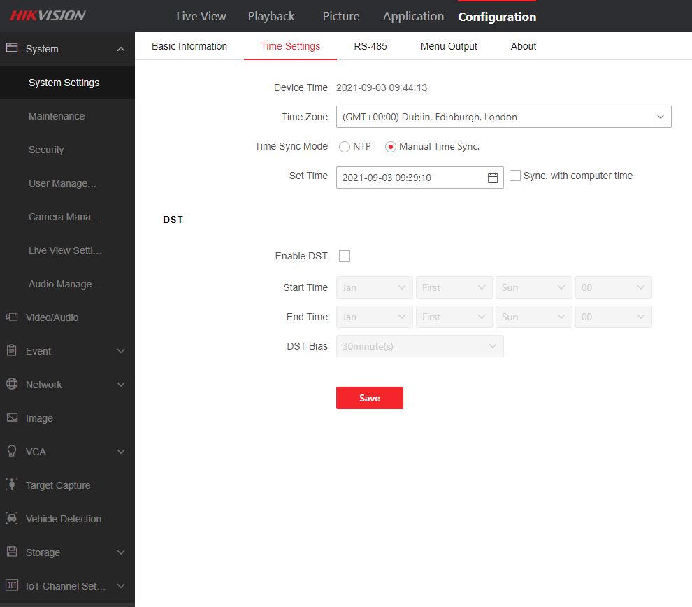

On the Configuration/System Settings/Time Settings screen in the web configuration tool, I've changed the Time Zone to (GMT +00:00) Dublin, Edinburgh, London" however the Device Time is still showing as an hour earlier (I'm in the UK).
If I click on the Sync. with computer time this sets it to the correct time, but isn't this issue about DST? If I check the "Enable DST" box I have to enter Start and End Times. What is this all about?
Here's the Time Settings Screen. It is currently 10:45:
How do I configure the NVR to show the correct time?
DST ist like summer time! You have to set when summer time starts end ends! or you use NTP Mode, so the camera will sync with time server from uk (you have to set).

Does this help?

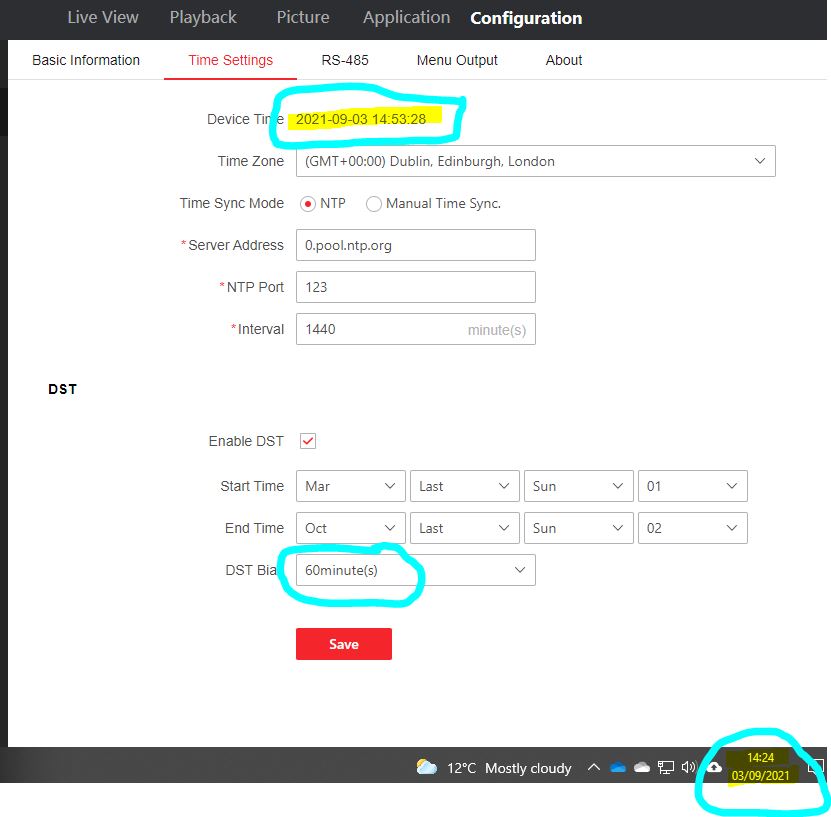

Confusingly, when I use your settings my Device Time shows a time that is 30 minutes faster. Reducing the DST Bias to 30minutes resolves that, but then I assume that is the wrong value to use given that the clocks change by 60 minutes!

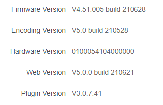

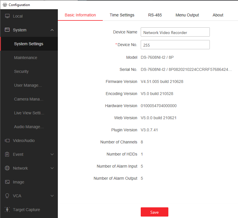

strange, what is your NVR model number and firmware release?
It's a DS-7608NI-I2-8P (DS-7600 series).
Firmware is the latest as I updated it this morning: V4.51.005 build 210628
I have the same NVR with V4.50.000 build 210125. My other NVR (elderly 7604) has the 60 minute offset as well. Maybe a bug?

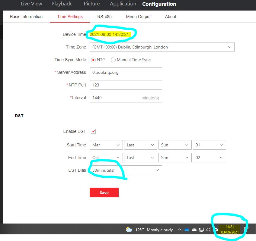

Just to confirm the issue I'm having with screen dumps.
I currently have it setup as follows:
DST Bias is set to 30 minutes and the Device Time and PC time (bottom right) are similar.
If I change the DST Bias to 60 minutes, as I believe it should be, the Device Time changes and is now 30 minutes in the future:

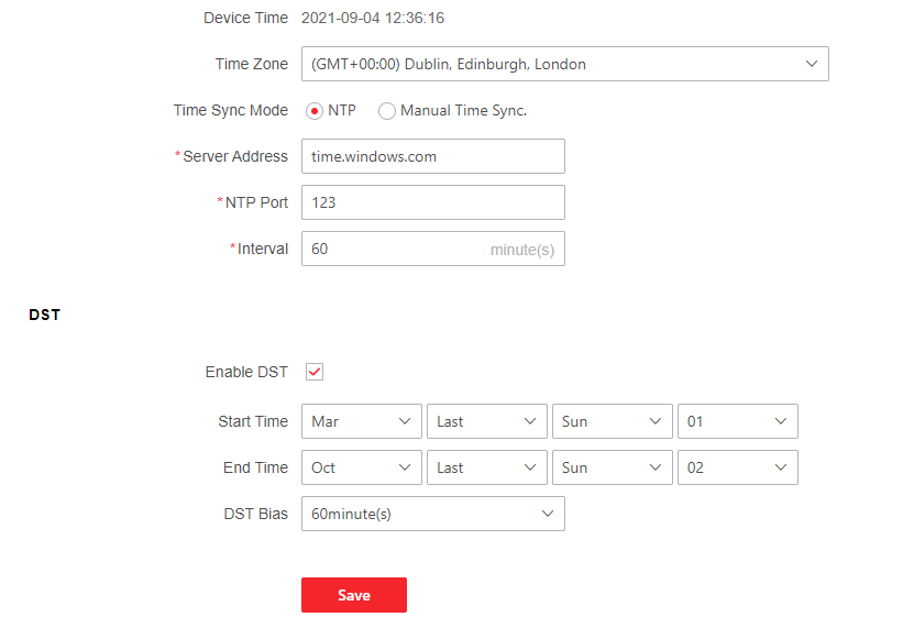

Is there any way of reporting this issue to Hikvision to get their feedback on what is going on as it appears that DST just isn't working!
I am not using pool but time.windows.com
Thanks for posting. I've just tried changing my config to use time.windows.com and it makes no difference. Whenever the DST Bias is set to 60 mins, the Device Time changes to half an hour in the future! No idea what is going on.
Are you using the same 210628 build as me:

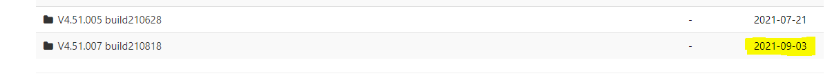

The link points to their latest firmware version, which was added only two days ago, so I hadn't used this when I updated my firmware three days ago!
I have now applied this most recent 210818 build and it appears to have fixed the issue. When I now set DST Bias to 60 mins, the Device Time stays at the correct time, rather than being updated to 30 mins into the future.
I wonder why Hikvision hadn't previously made this firmware version available, unless it was just coincidence it appeared when I raised this issue.

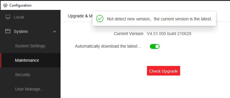

PS. The iVMS-4200 software didn't detect a Firmware Upgrade for my box and states "No available version" (even before I upgraded). Also, the "Online Upgrade" page of the Maintenance menu for the NVR didn't detect any further firmware versions when I clicked "Check Upgrade":
It would appear this latest firmware version hasn't been properly registered to allow the software to detect it or the Hikvision software is just very flaky!
