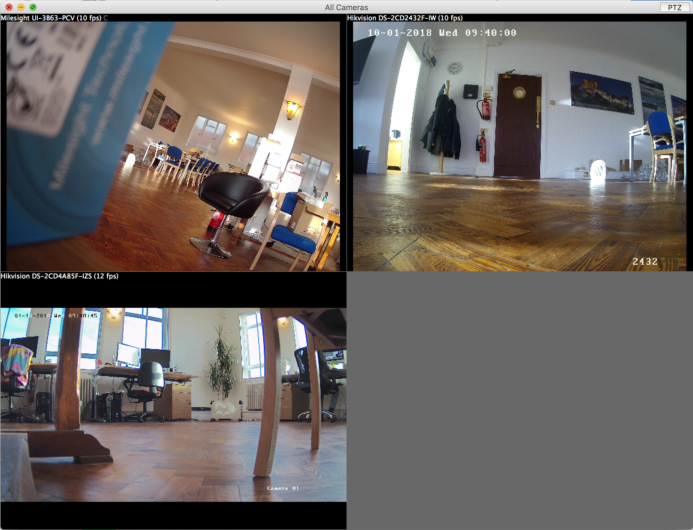

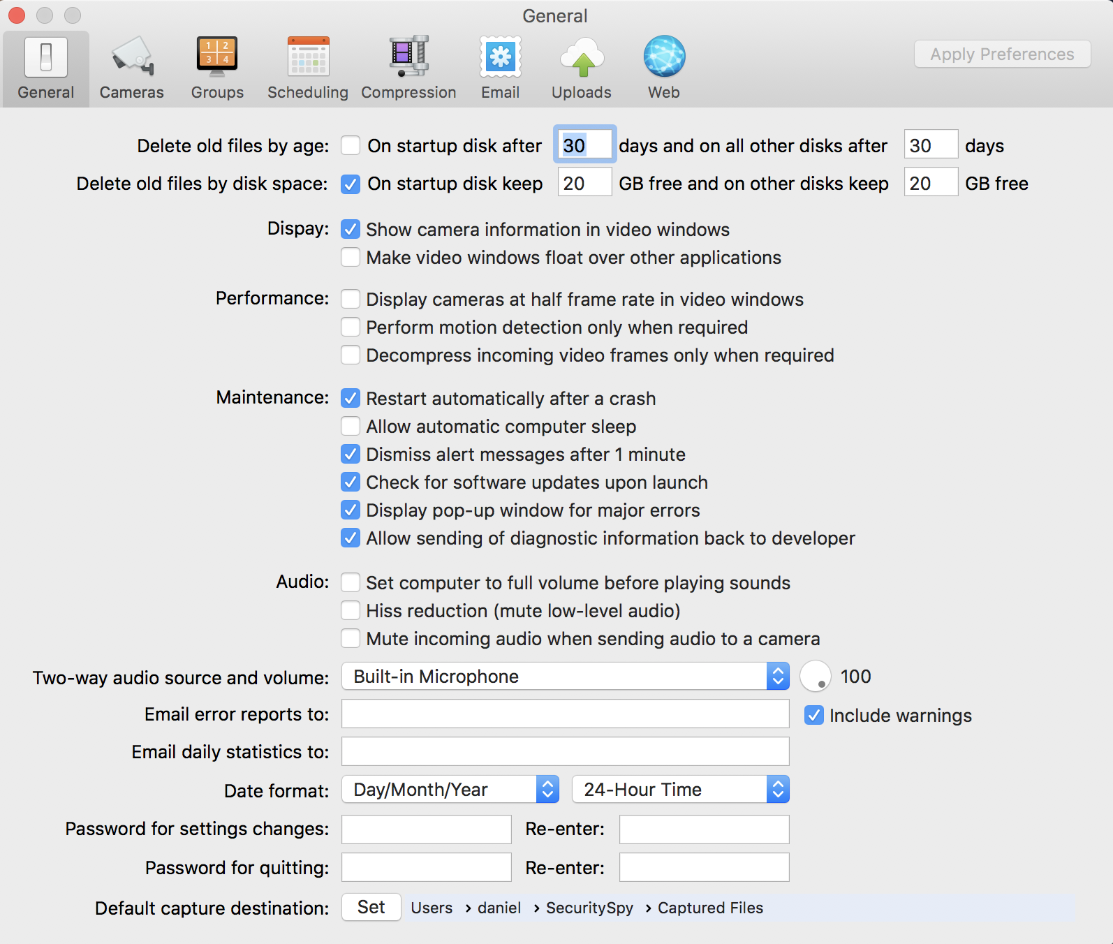

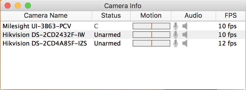

We recently downloaded the Security Spy 30-Day Trial to see how Milesight functioned with the software and how user-friendly the software was in general, and as you can see from the pictures below the software is designed, like any good Mac software, with ease-of-use in mind. On initially opening the software some Mac users who have never installed an IP system before may struggle with getting started, but Security Spy offers a range of support including user manuals, FAQs, and a forum.
