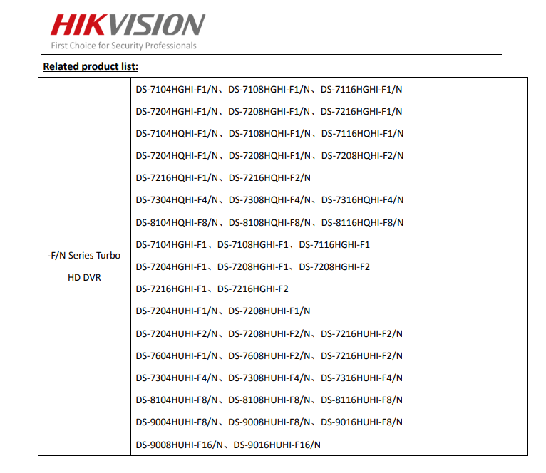

Question 2
My old DVR model number: DS-7204HGHI-SH0420150715AAWR*********WCVU
the firmware seems well old as it says extranet access and not platform access, I have downloaded a firmware file from the site, details below.
It seems self explanatory but just wanted to be double sure, is this the latest and correct firmware?
Thanks in advance
