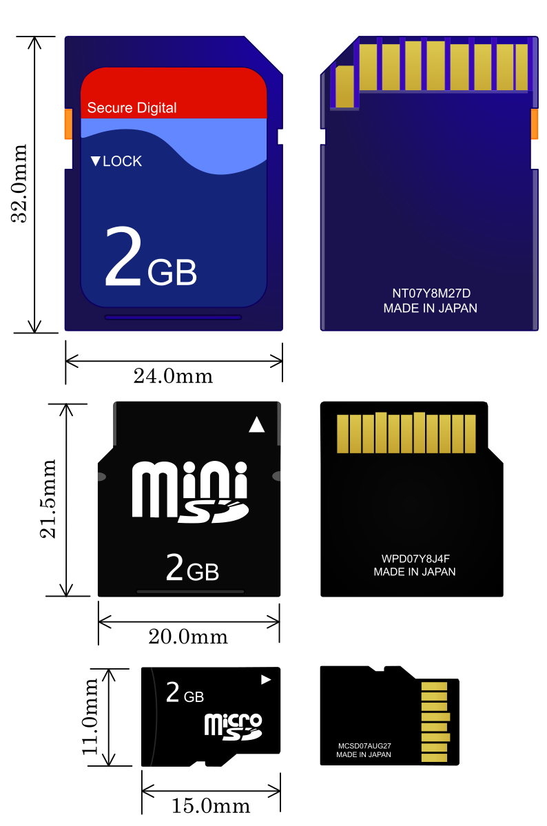

Yes I understand what an SD card is.
1) why have them in my cameras, and what do they record which is different to what's recorded on the HD?
2) why have them and what's their prime role when you have a HD in the NVR
3) how do I access what's on them.?
Ah, I guessed you were somehow getting confused between Standard Definition and High Definition.
Hard Drives are generally referred to as HDDs - Hard Disc Drives.
