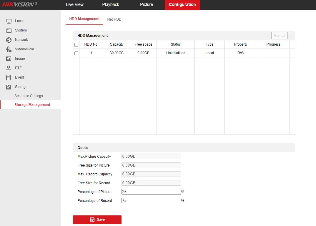

I have a dome camera:
Type: DS-2DE4A220IW-DE
Firmware: V5.5.71 build 180725
I am recording 24/7. But when the internal SD card is full, then the recording stops.
Is there a way that the camera automatically overwrites the oldest recordings?
Thanks!

Hi @Roelli
If you go to Storage > Schedule Settings you should see an Advanced button at the top right of the schedule.
Click this and you should see a pop-up menu with a tick box labelled Overwrite, tick this and the camera should overwrite the oldest footage on the MicroSD card.

Hmm... somehow the "problem-camera" says:
Status... "Uninitialized".
I can format... but... that does not help. Probably I have to change the SD-Card?

Hi @Roelli
In regards to the MicroSD storage, are you saying that even after formatting the card it still says "Uninitialized"?
Exaclty!
I tried it several times.
I restarted the camera... tried it again... does not work.
Maybe I need to change the SD-card? (it's of course the camera where it's most complicated to change the sd card) like always :-)
Hi @Roelli
If the SD card is still showing "Uninitialized" after formatting that would suggest there might be a fault with the MicroSD card, please try another card and see if anything changes.

if the SD card is still showing "Uninitialized" after formatting that would suggest there might be a fault with the MicroSD card, please try another card and see if anything changes.
Ok, I will order a new microSD card. Any recommendations regarding speed, manufacturer and maximum size?
We sell/recommend Samsung MicroSD cards and for an older model like this, we probably wouldn't recommend going larger than 128GB as the camera may not have been tested with the larger cards.
You don't have to go with Samsung cards, if you do go with another brand we would recommend only using cards that are SDXC and Class 10.
