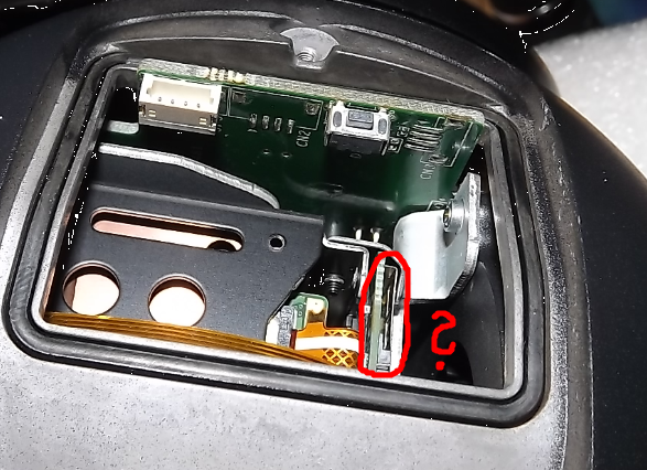

does anyone know where the sd card goes on a hikvision DS-2DE5220I-AE, I don't want to blindly start dismantling the camera looking for it.
anyone?, I am holding off installing this on the bracket until I fit an sd card so that I don't have to dismantle everything after fitting. I have been through the instruction manuals and the hikvision website and spent hours googling and can only see one utube video doing it on a mini dome , my camera is a ptz 5" turret and I would appreciate a link or download to show me the location of the slot.
Hikvision's documentation unfortunately doesn't show the location of most microSD card slots on their cameras.
I'd expect with your model that the back panel of the black camera body will unscrew and you'll find the microSD card slot underneath.
hi , thanks for the reply, I did remove that panel but I cant see it, I might wait until a younger pair of eyes arrives home this evening

hi, thanks again, I have had the cover off and I still can see nothing resembling a card slot .
Look at the red highlighted part...this seems to be a sd slot?

you are spot on, I have had my daughter(she has better eyesight than me) confirm that. I have removed the original pics I posted to clean things up a bit. thanks for taking the time to do the highlighting for me:)( shame hikvision didn't label this in the camera or at least point out the location in their instructions/website):mad:

hi, thanks for that but I can find nothing there for my own model but you did correctly identify the sd card slot in the picture, hopefully that will be the only conundrum facing me
