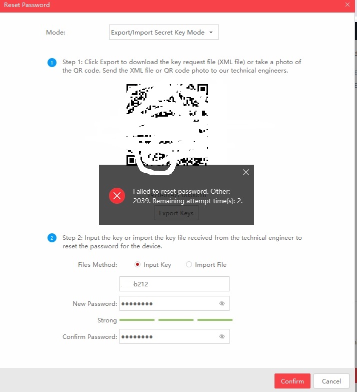

I got the same error as the colleague above, I followed your steps and got the same error. Failed to reset password. Other:2039. Remaining attempt time(s): 2
Device model: DS-2CD1343G0-I.
thank you in advance

Hello,
Another problem I seemed to have (I was trying to reset 10-12 cameras at the same time) is that something was messing up with getting so many codes at once. You could try doing them one by one and see if you have any better luck.
Alternatively if you ask them nicely enough they can remote into your machine and do it themselves via TeamViewer but it seems they will only do one or two as I imagine this could take up a lot of their time.
Good luck!
Hello
I have only one IP camera in the system and I emailed hikvision support with the error, I get different reset codes but the error is the same. But I don't understand what error 2039 refers to.
==Failed to reset password. Other:2039. Remaining attempt time(s): 2==

The XML file is fine to use, this is what we usually receive for password resets (along with the code) - just upload this when you select the "import file" option :)
Have you checked / tried all of the things in post #3 above? Those are all things which we've known to cause password reset errors.
The latest version of SADP is available here - SADP
The reset files also expire after 48 hours, so you may need to do another if it's been longer since you received it.
Thank you Kyle, it worked
I wasn't using the latest version of SADP tool
