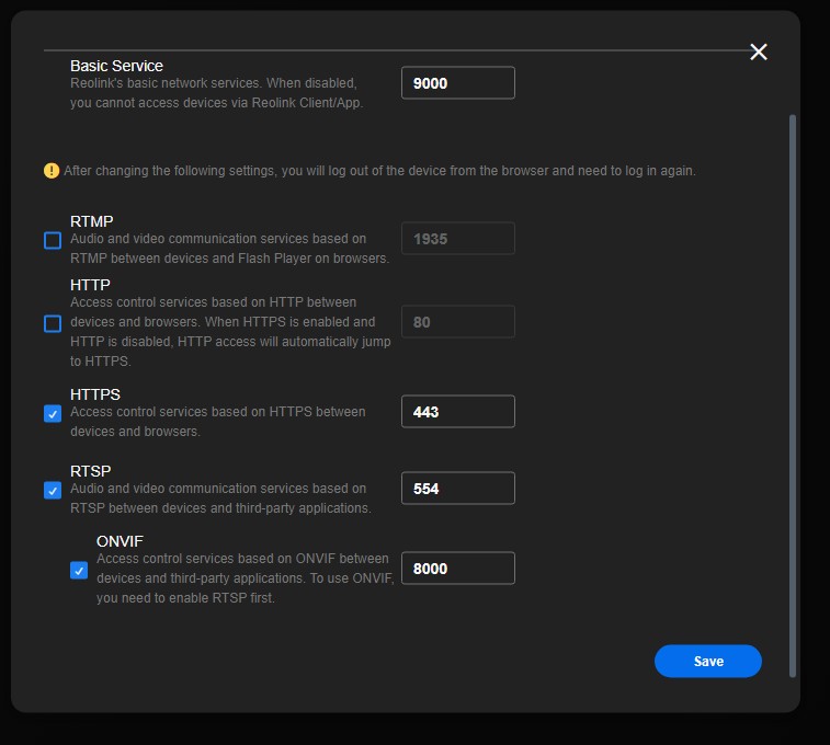

Took me hours to get the Reolink RLC-810A to display on a Hikvision NVR DS-7108. I did not give up since I read the previous post that gave me hope. But in my case a few other items of note. My Router uses the 10.0.0.1 Gateway, the NVR assigns 192.168.254.* series IP's to the cameras as internal which must stay that way apparently. So separately I assigned 192.168.254.5 as the IP in my case its camera #3. Also ONVIF was not enabled in the camera settings which caused much wasted time. There is a setting under basic service RTSP port 554 must be checked to enable the ONVIF port 8000.
