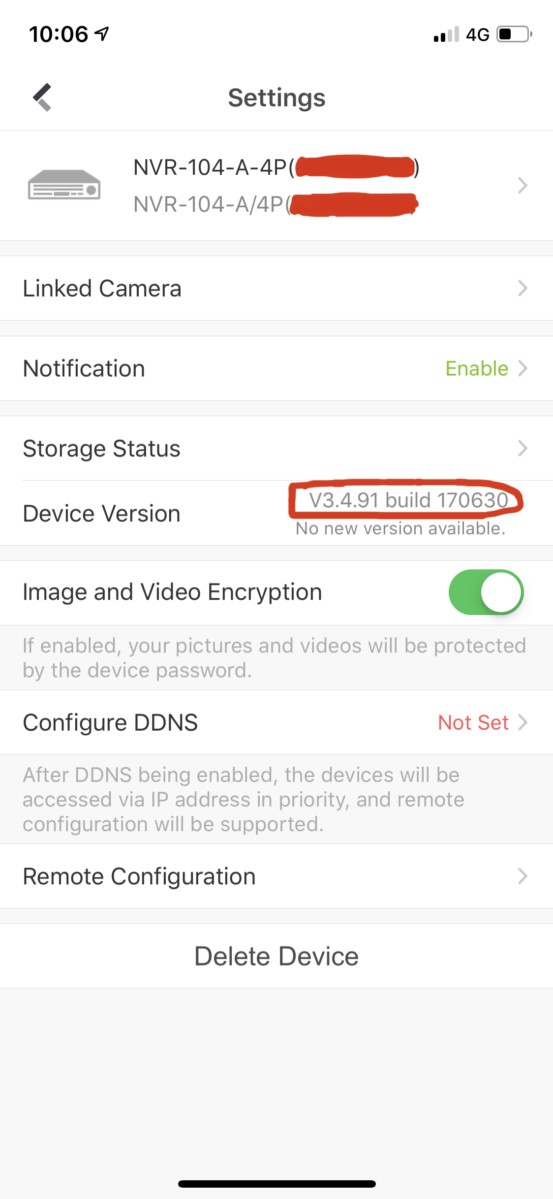

Thanks for the info. Is this the firmware version on the attached photo? (Highlighted). If so, that states “no new version available” :(

That would appear to be the latest firmware, unfortunately, unless you bought these HiWatch products from an authorised Hikvision reseller you are unlikely to get much support with it. Hikvision released HiWatch, lots of sellers bought large amounts of stock and then less than a year later Hikvision announced HiLook and said that this would be replacing the HiWatch range, so now lots of suppliers are selling their remaining HiWatch stock very cheap to try and clear it and then not backing it up with any support.
I would still check the camera?NVR firmware using the above portal and then try HiWatch support and see if you can make any progress.
