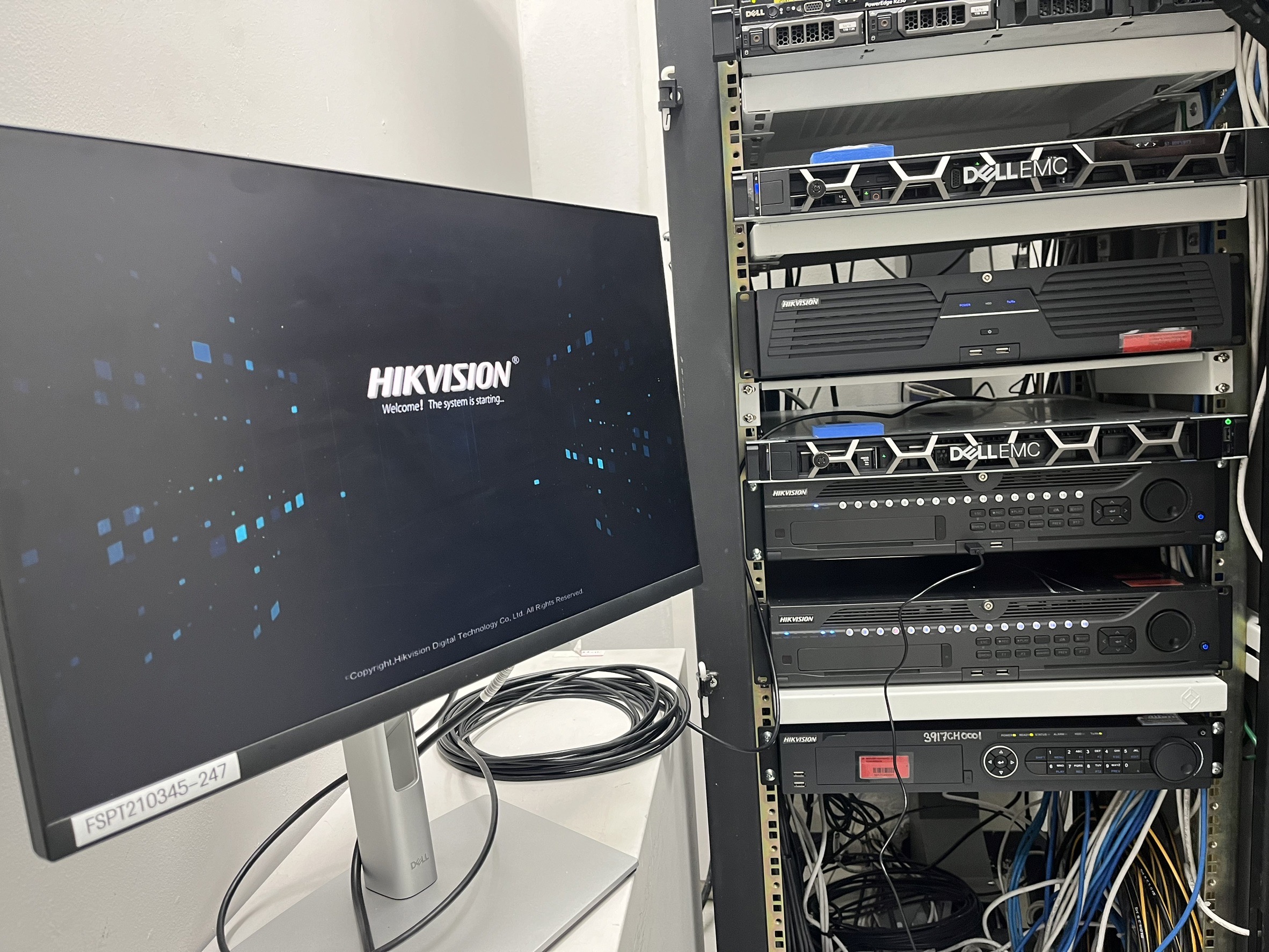

But during such time You can still view images of current events as usual.
Therefore, the initial fix was made by rebooting the NVR. After rebooting the device is complete, the NVR can see the HDD normally and historical data is recorded normally.

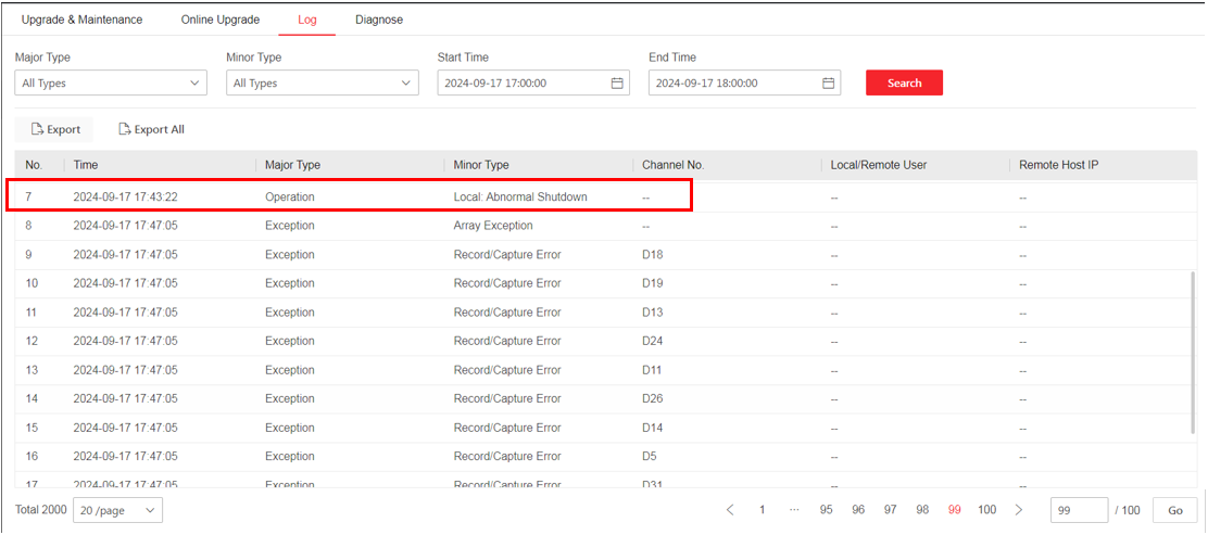

After looking at the log, I found that
Local: Abnormal Shutdown
What can I do? And is there any channel that can solve this problem?

Have you tried cycling the power? After you turn the NVR off for 20-30secs and then turn it back on again, does it keep rebooting?
If it does stop rebooting, can you get into the NVR to confirm if firmware has been installed?

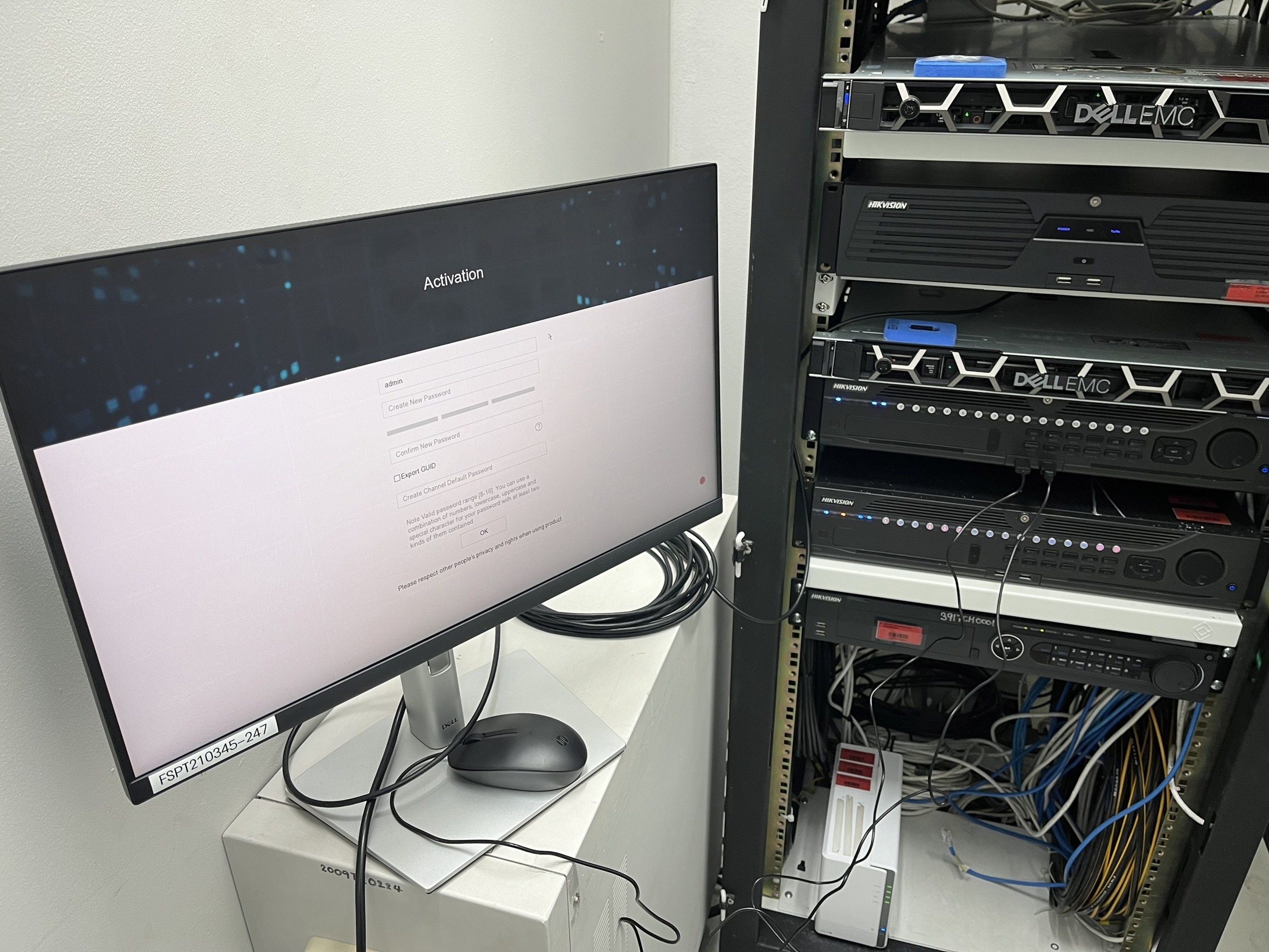

@Dan Now I just removed the HDD and the machine powered on again.
I still have the HDD plugged in but the machine still won't turn on.
Now my NVR is upgraded to the new version.
