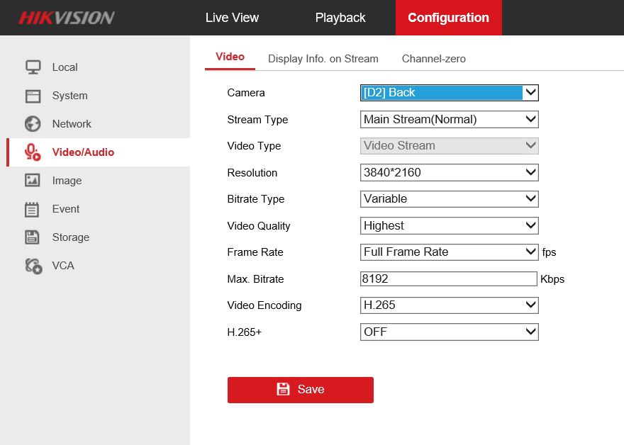

I have attached original settings from parameters page in record menu. Lines missing from this that are on dedicated monitor are: Bit Rate Mode -General and Max bit rate recommended 25411-42352kbps. Max I can set is 8192 otherwise I get error out of bandwidth.
Can you advise best setting for this page.
I noticed on maintenance screen, system info bit rate is variable and sometimes goes over the max 8192. Not sure if that's an issue.
Live view Strategy is set to balanced, other options real time and fluency. is this best?
Have you tried enabling h.265+?
The last field in your screenshot - set it to ON (and save the settings) - each camera will reboot after.
This is the most efficient CODEC (for bandwidth and storage).
Hikvision's h.265+ CODEC
Your other settings look fine.

In order to achieve this I have my encoding on H265+ Mainstream with max bitrate set at 8192Kbps, sub stream is on H265 with max bitrate at 256Kbps.
If I go any higher on either stream settings I get the "not available " error on sub stream and therefore loose the multi screen view. The only way to recover use of sub stream was to reset camera.
