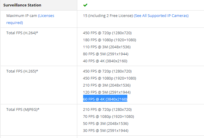

Hi Jan, I'd love to have SSS to play with. That said, my understanding of their NAS products when using Surveillance Station is based on frames per second. For example a DS118 has the ability to handle 450 FPS @ 720p (1280x720) or 60 FPS @ 4K (3840x2160). Suppose you had 2 cameras at 30FPS recording at 4K that would be the limit of the DS118 (or 15 cameras at 30FPs at 720P). This is found under the specs tab of their various models. Keep us posted.
