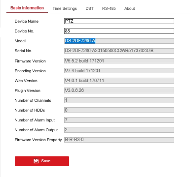

Nothing newer? These old boyz with the SmartTrack are super reliable
Upvote 0
Hi @shaunj187za
This PTZ model has been obsolete/EOL for a while and the v5.5.2 firmware you are currently running is the last firmware for this camera.
