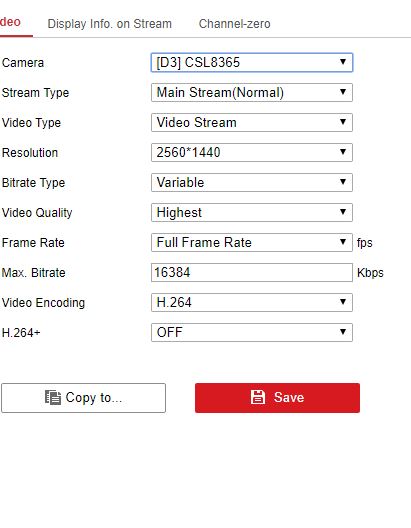

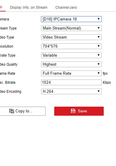

I have added the cameras to the NVR via the same method and have added the screenshots that show the different settings i can configure via the NVR (if i log directly on to the camera I can set everything correctly)
