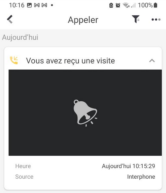

BUT ! Because there is a but... On hik-connect, I have a gray bell instead of the caller snapshot.
For those who have a Hik-Vision IP visiophone, when you missed a call, do you have the screenshot of the caller or do you have a gray bell?

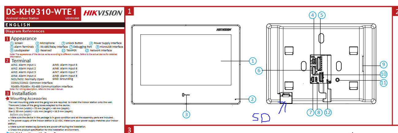

Hi @Kyle
First of all, I will apologize to you because there is indeed an SD card slot! I discovered it by accident...
But in the datasheet or in the docs they don't refer to it (cf. image).
So I put a 16 GB SD card but android asks me if I want to extend the existing os or if I want to make it an external storage.... Still can't find the info...
As for the French support .... how to say ... Worse than anything I've seen.
I tell them that I am connected in RJ45 and they tell me that my wifi is not stable... When I think I wanted to buy everything in HIKVision: Camera, NVR, alarm... I'm very cold now!
If it is not possible to receive the photo of the person who rang the doorbell, I do not see why buying this tablet and this module at this price.
I've already wasted far too many hours trying to turn this very expensive android tablet into a connected doorbell, so if someone who has the same config as me could tell me if he has the photos (or not...) I will know what to expect.
Thanks again to everyone :)
Ced
Thanks for the update.
I believe that you will need to select the option to use it as external storage but am not certain.
I've asked Hikvision if they can confirm this and will let you know what they say, as I cannot find anything relating to it in the indoor station manuals.

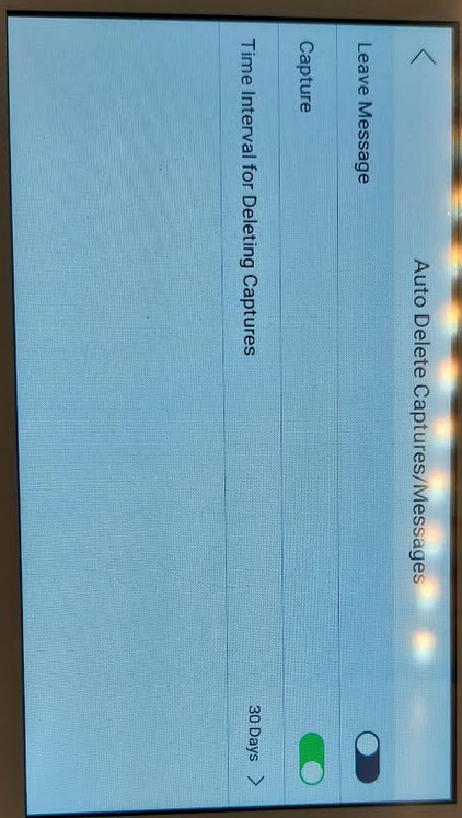

Hello,
I just reseted everything one more time. Rebooted a few more times, and toggled that "capture" setting, and for the first time I saw a snapshot on hikconnect.
My firmware version is V2.1.74
I wish you the best luck
Hello,
Same firmware. If I turn the capture on it fails to call the mobile. Again reset and reboot a few times.
My experience has been
If capture is not on, then it doesnt even take a picture for the local album.
For calling the mobile, altough it is online and it shows eveything as online, it doesnt call. To reset that, i had to toggle dhcp setting, which somehow resets network.
Then both of them start working

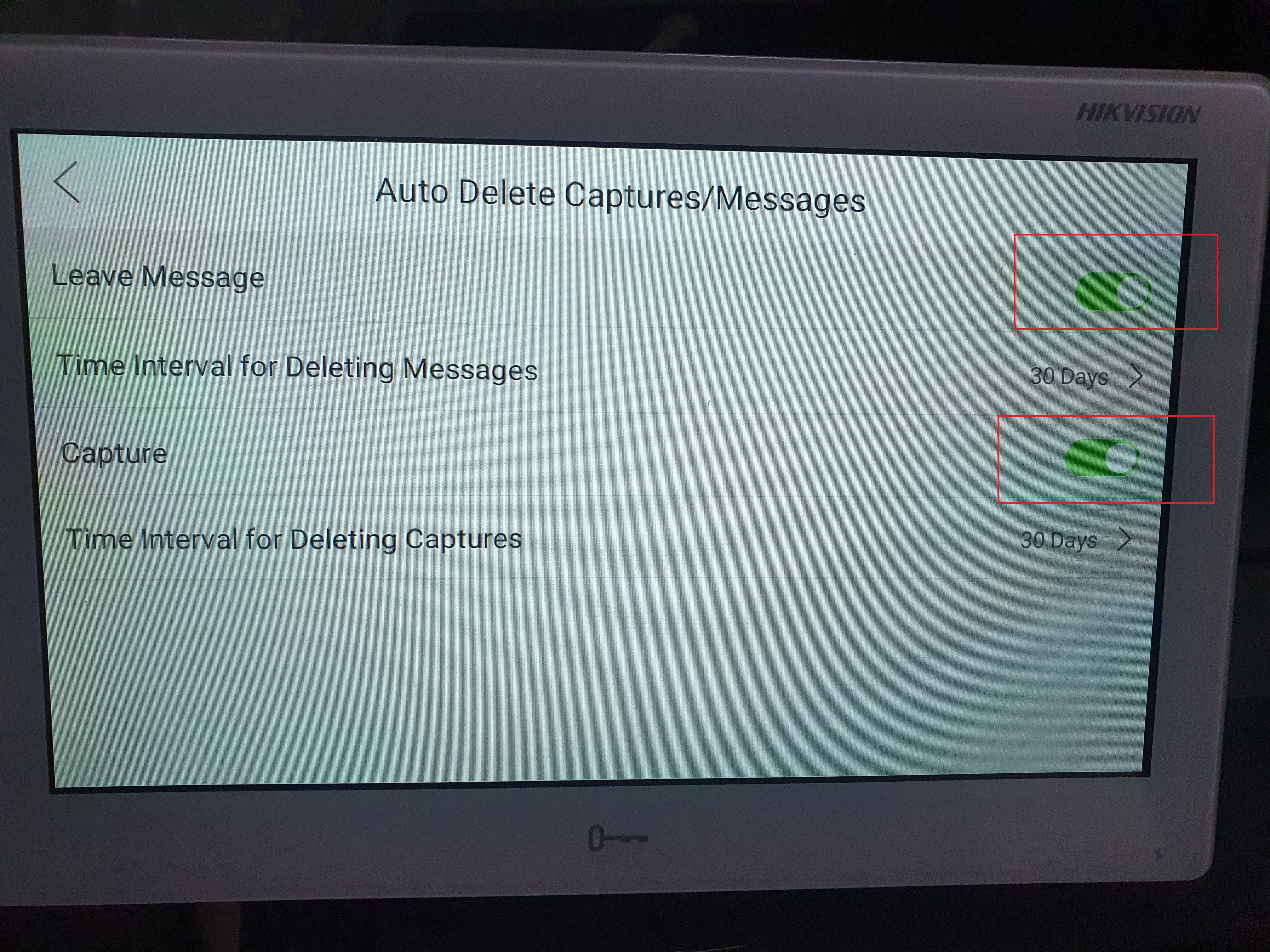

Not exactly the same here, but almost. DS-KH9510-WTE1(B) firmware V2.1.74build 221110:
When there is an sd card inserted, although it is online, in hik-connect it only offers the live camera feed and can activate mic/speaking. No calls and no push messages and no history. Only calls and snapshots on the indoor monitor (but snapshots only after "Leave Message Time as 1 day, 7 days or 30 days" is set. It took me hours to figure this out..)
But as soon as I removed the sd card, all calls and push messages are send to hik-connect.
I just have to NOT insert an and card: Then the monitor seems to store snapshots in its internal memory AND notifies the surveillance center (hik-connect cloud).
DS-KH9510-WTE1(B) firmware V2.1.74build 221110 and samsung 256gb microsdcard
Doorbel model : DS-KV6113-WPE1(C)

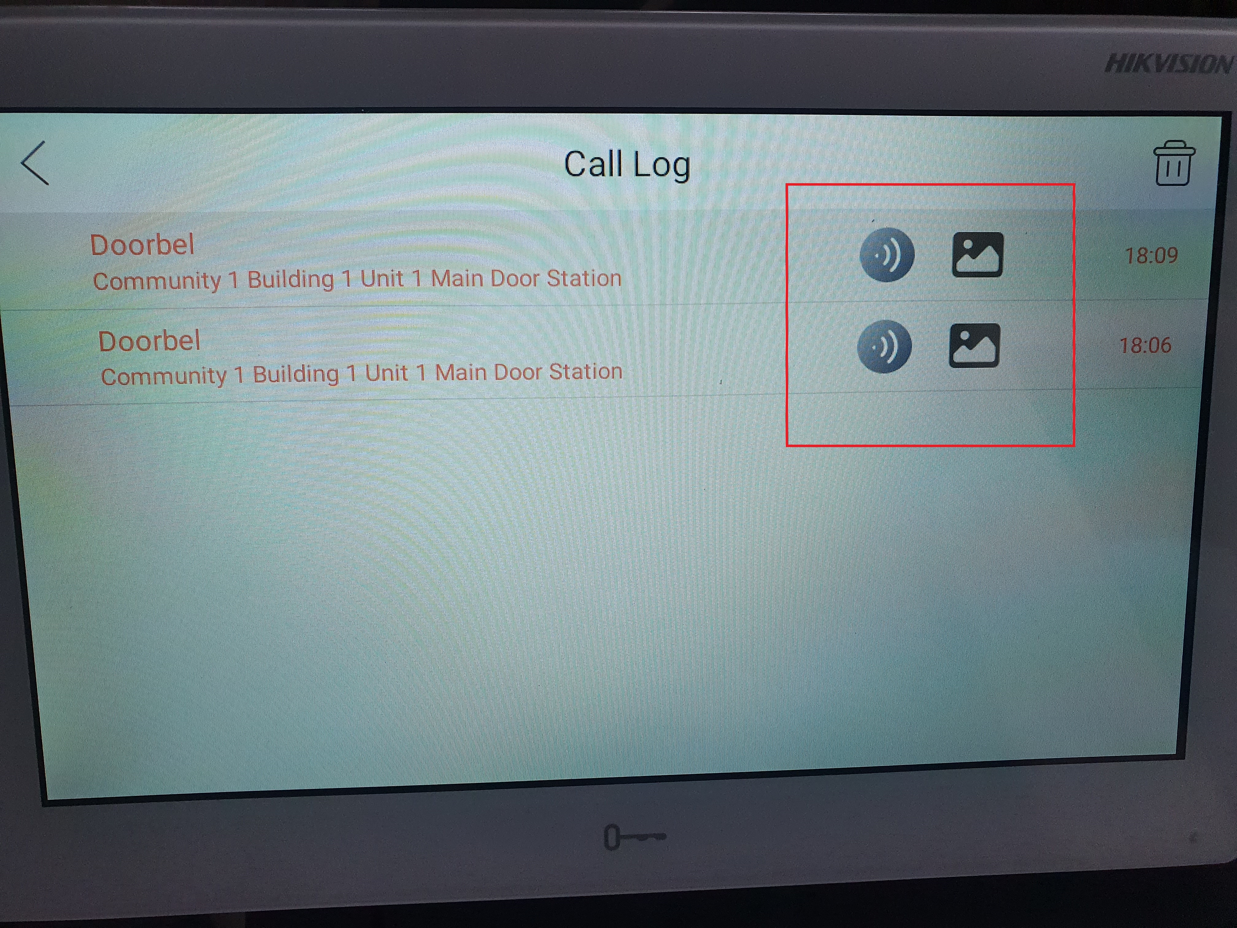

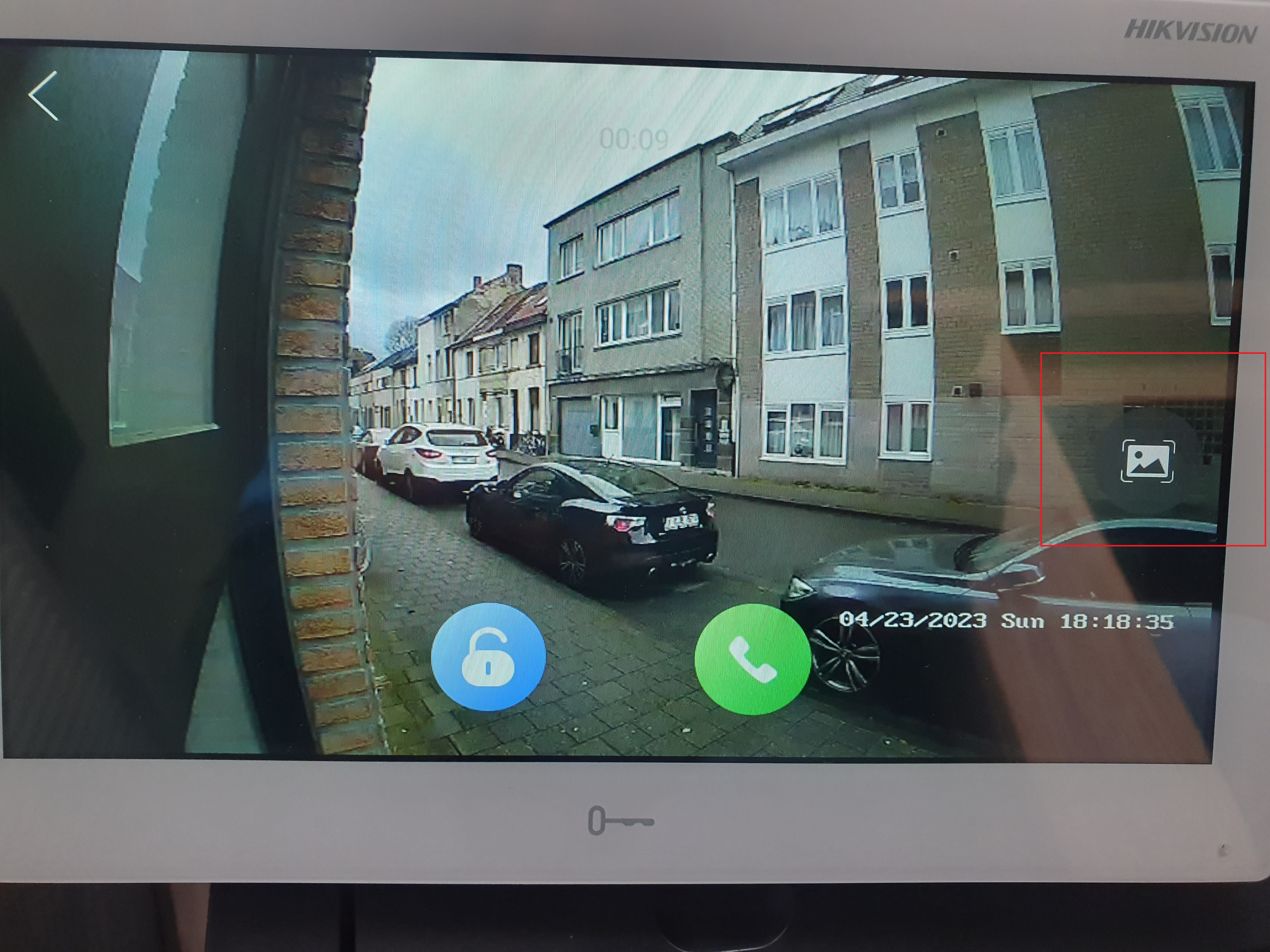

As a result of long efforts, I found such a solution.
if you make these active photo 1
*You can get a snapshot at the time of the call (photo 2)
*you can see pictures in call history / photo 3 (including sound recording, not recording video)
