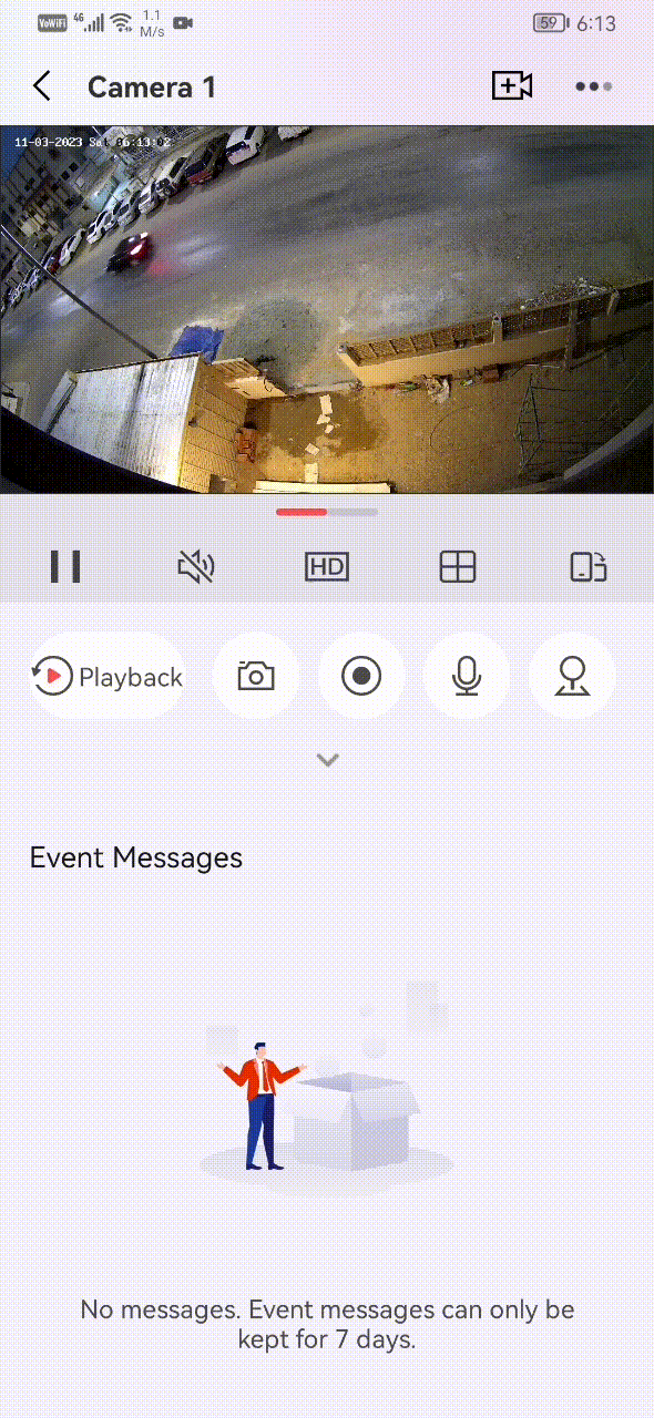

Hi!
I have DS-7608NXI-I2/8P/S
I have updated it to
V4.62.200 build 230105 I downloaded it from Hikvision International website
One of its advantages is the addition of the event/vehicle/human when viewing recording from Hik-Connect app.
But the problem is when you click on Playback option in Hik-Connect app, it takes a very long time, it may reach 1-3 minutes, so that you can watch recordings, while in older NVR updates, after clicking on Playback, recordings appear within a few seconds.
Is there a solution? I tried it on iOS and Android and multiple versions of Hik-Connect app, but the same problem
Can I downgrade NVR to old update to avoid this problem?
