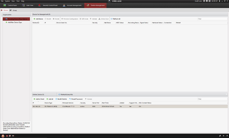

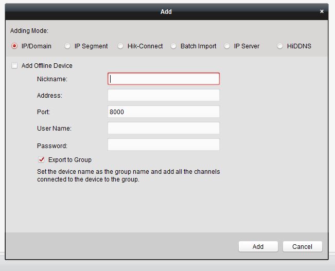

I am having a problem with adding my setup to iVMS-4200. My NVR is the DS-7604NI-K1/4P and when I try to 'Add the device' it just will not populate the serial number and I assume that because of this it will not work.
Hopefully someone will be able to help. With luck the screenshots that I have attached will be able to be opened so that you can see what I have at the moment.
I wonder if I am trying to add the device incorrectly. If someone could point me in the right direction I will be extremely grateful.
Many thanks in advance of any help that may be forthcoming.

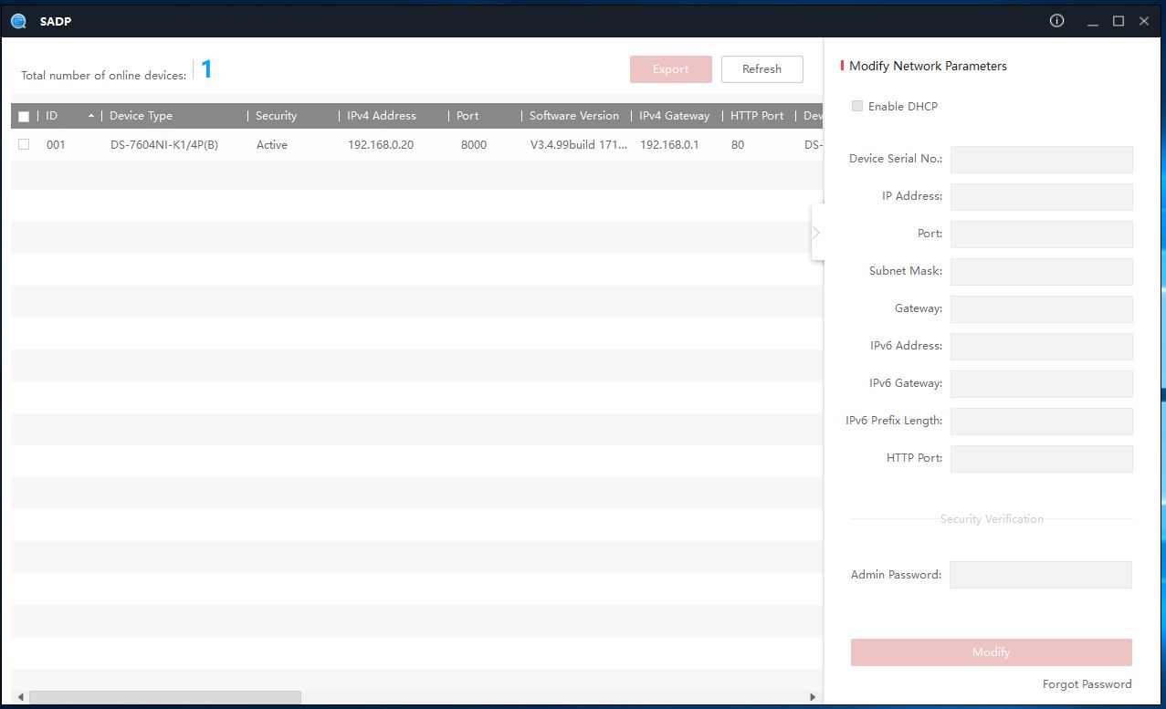

Is your NVR successfully added to your network?
If you run their SADP utility on your PC, does it show the NVR with the router's IP address correctly set, and an appropriate IP address for the NVR?
The latest version of SADP can be downloaded here:
DOWNLOAD PORTAL
Feel free to upload a screenshot from SADP.
Don't reveal your NVR's full serial number please.

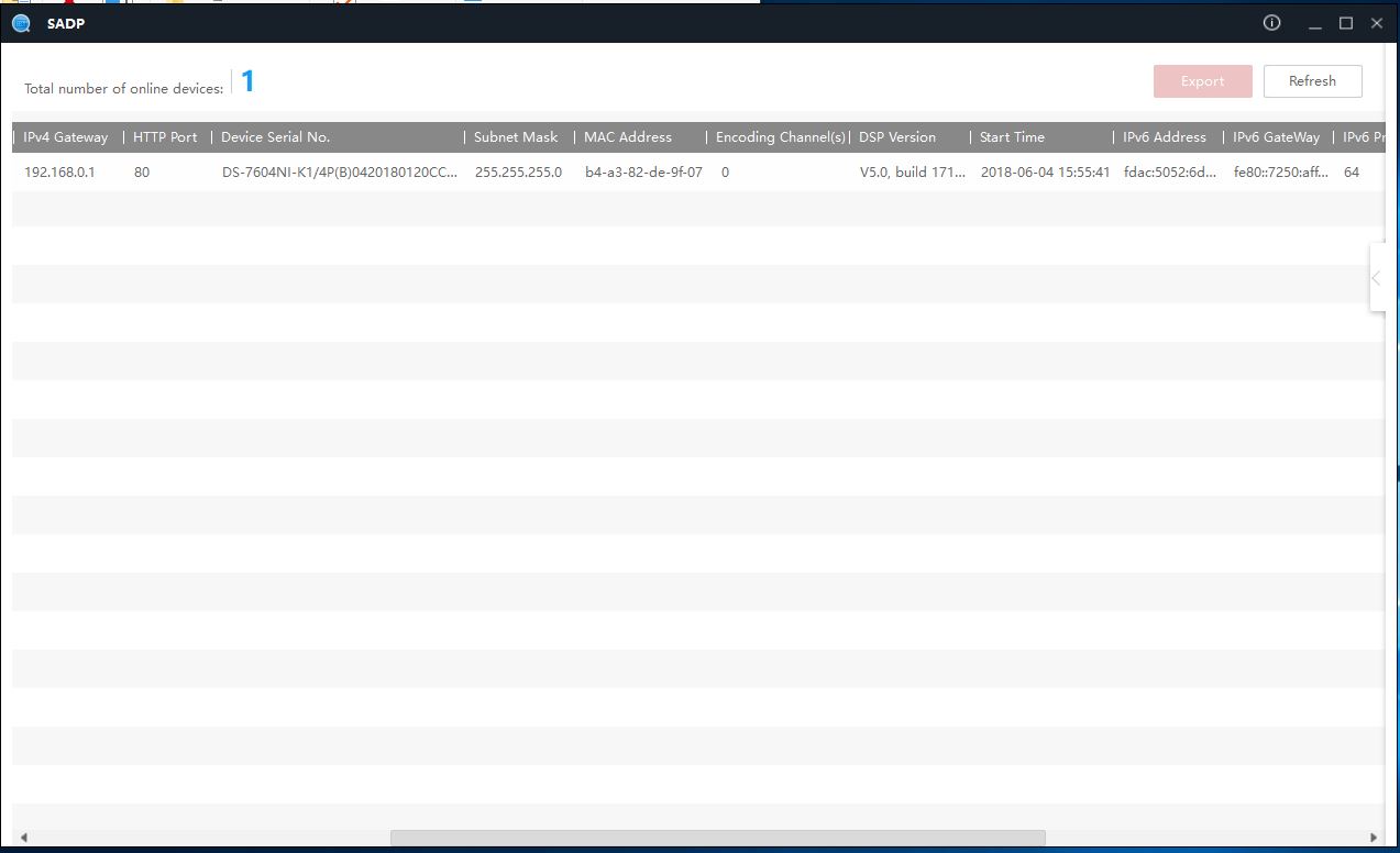

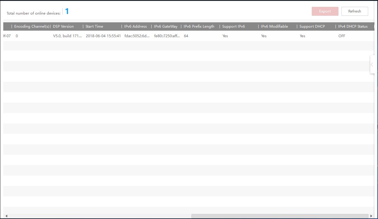

I'm reasonable with computers, but not that brill (I'm 78!) I have attached 3 screenshots of my SADP screen because I can't get it all in on one screen and don't know how to. Hopefully what I have attached will be sufficient for you to help. I've left the bit out that shows the serial number as you have suggested.
OK, that looks fine.
Interesting that your NVR has shipped with a newer firmware version than is currently available from their portal (you have V3.4.99):
DOWNLOAD PORTAL
FYI - If you tick the box at the left end of the row in SADP that shows its details, then it populates the fly-out at the right with those details and alllows you to view and change settings.
Your NVR's network IP address is 192.168.0.20
If you open Internet Explorer (not Edge) on your PC and type that IP address into the address bar you should be able to login to your NVR to live view and edit configuration etc.

Phil, it's all sorted thank you. The encryption key is actually the verification code, when I entered that it worked a treat.
